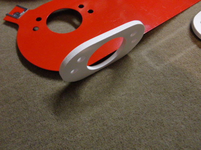

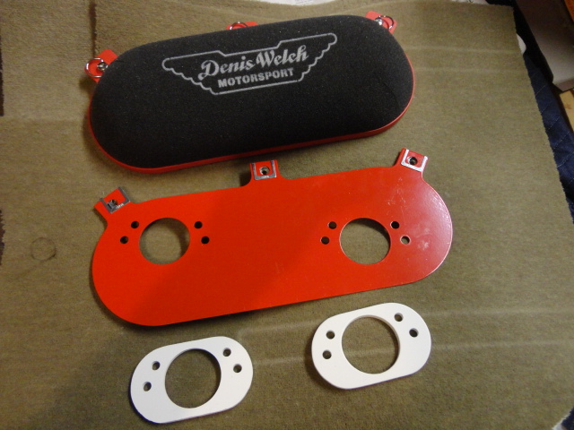

Dennis Welch claim they tested a BJ8 before and after they installed headers and the difference was 8 bhp.
I wonder if they did that to the air-cleaner that they claim an increase of 6 bhp for the BJ8's?
