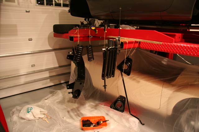

Anyone have good results painting coil springs and sway bars with POR15? Is is flexible enough?

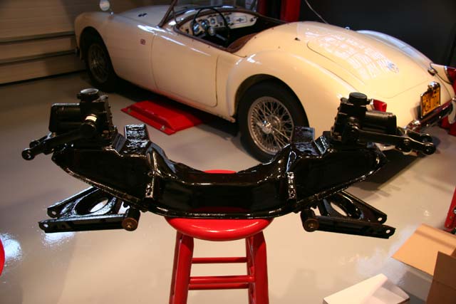

Parts look great Steve. Did you blast & prime?
Blasted clean, then etched with Metal Ready and rinsed with water.

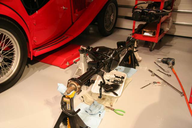

Also painted the rear axle and all related parts the same way a while back.
Man. I can't wait to get to do that. I also gotta get me an impact driver like that one.
When you get the impact driver, get a rubber boot for it like the one on mine in the photo. It just may save your paintwork if the tool goes crazy.
