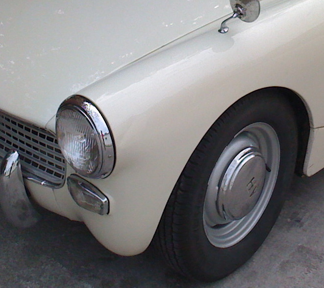

What should I read there? Here's a picture of one of the wheels I installed:
