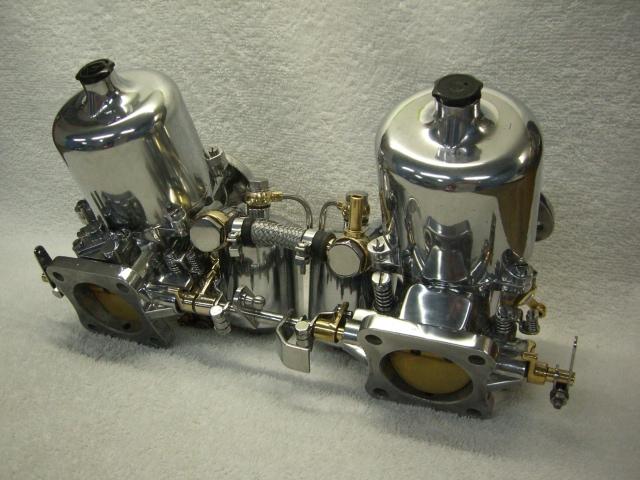

I used a sisal wheel with rough cut compound, then a spiral sown wheel with fine cut compound, and finished with a loose wheel and polishing compound, then finally a hand rub out. They looked great and then I had to spend hours cleaning up the mess around the buffer.
Wow

Those are not mine, I wish. Done by a member here though.
I did notice they looked a little big for the Sprite... shiny though! I might whip out Rosies (the new Sprite has been named!) and try the barkeepers friend on them. They are pretty calcified though so how good they'll come up is anyones guess!
