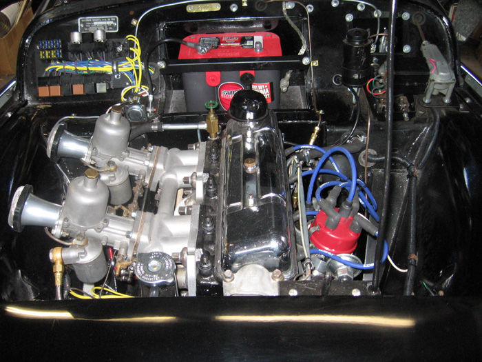

I don't know how <span style="font-weight: bold">shiny</span> you want your aluminum, but in the picture below, the carbs and intake manifold were first thoroughly cleaned in mineral spirits and then scrubbed with steel wool that has the soap in it. Rinsed and dried, and that was it.
I like the clean, natural finish of aluminum.

Very nice engine bay, Art, like she just rolled off the assembly line. :yesnod:

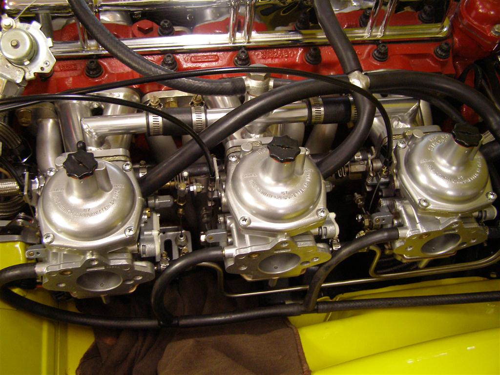

I polished only the tops of my Strombergs as I did not want to deal with all the nooks and crannies with the carb bodies. I started the same as everybody, experimenting with steel wool, scotch-brite pads and aluminum polish, in this case, Autosol brand. Results were so so at best. Prior to this my buddy glass bead blasted my carbs so they were pretty clean but I did not get the desired effect with the above polishing method. I started experimenting with my Dremel and found that the small. round brass wheel did the bob. I could see the effect immediately. After going over the whole acrb top with the wheel(s) (I used up three doing both carbs) I again used the Autosol and a soft cloth. I was really happy with the results. Note: I tried the Dremel stainless steel wheel and found it too coarse and it scored the body a little and I had to clean up with emery cloth and the brass wheel again. I have a couple of parts carbs and did notice that not all carb tops are real smooth like the first two. There is some scoring and rough texture tat would not come out but they still cleaned up nicely. If this crappy pic with the carbs in the in the background is any help I will try to get a better pic and post it. Good luck.

Here ya go Glemon - a pic of the carbs only.

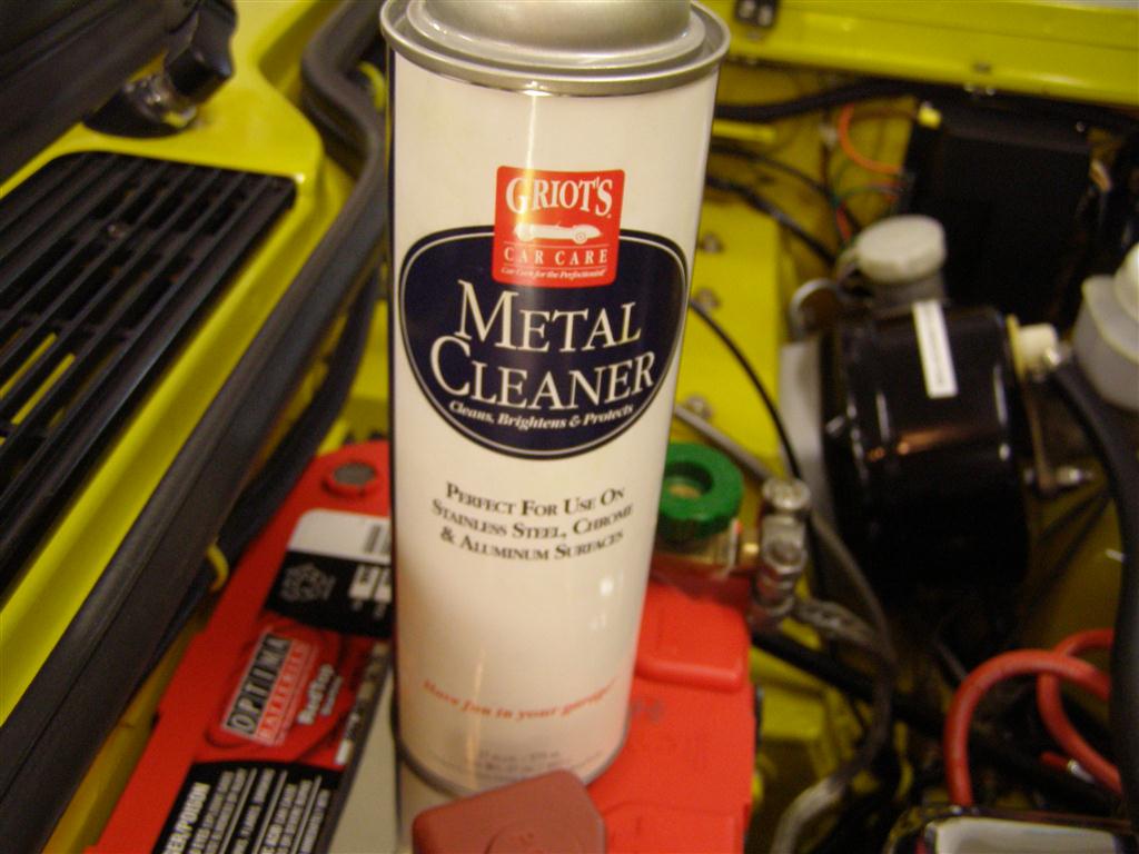

I probably should have chimed in here early, but I almost forgot about something that I use that works very well on the carbs. Griots make an aerosol spray Metal Cleaner that is good for everything including stainless steel.
When I added the GP triple heat shield, I used some along with a tooth brush and micro fiber towel to clean up and polish my carbs. They came out really nice in all of the nooks and crannies and it leaves a nice protective film on them for the future. the more you buff, the shinier they get until it just becomes time for the Billet polish or a similar product.
I have the new 3" Griot buffer and plenty of their metal polishes and pads, so I may play with the carb tops over the winter if I get some time.
