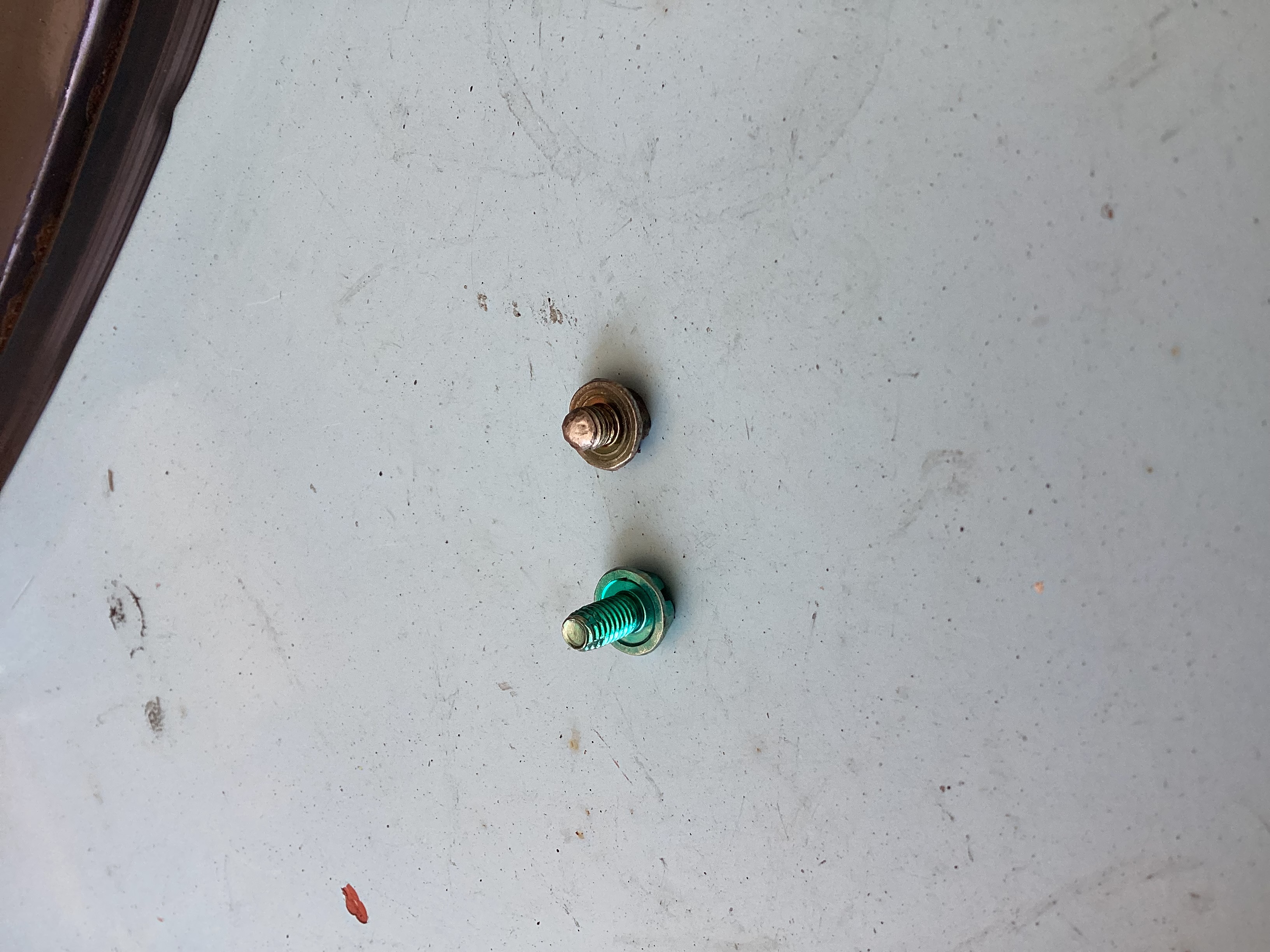

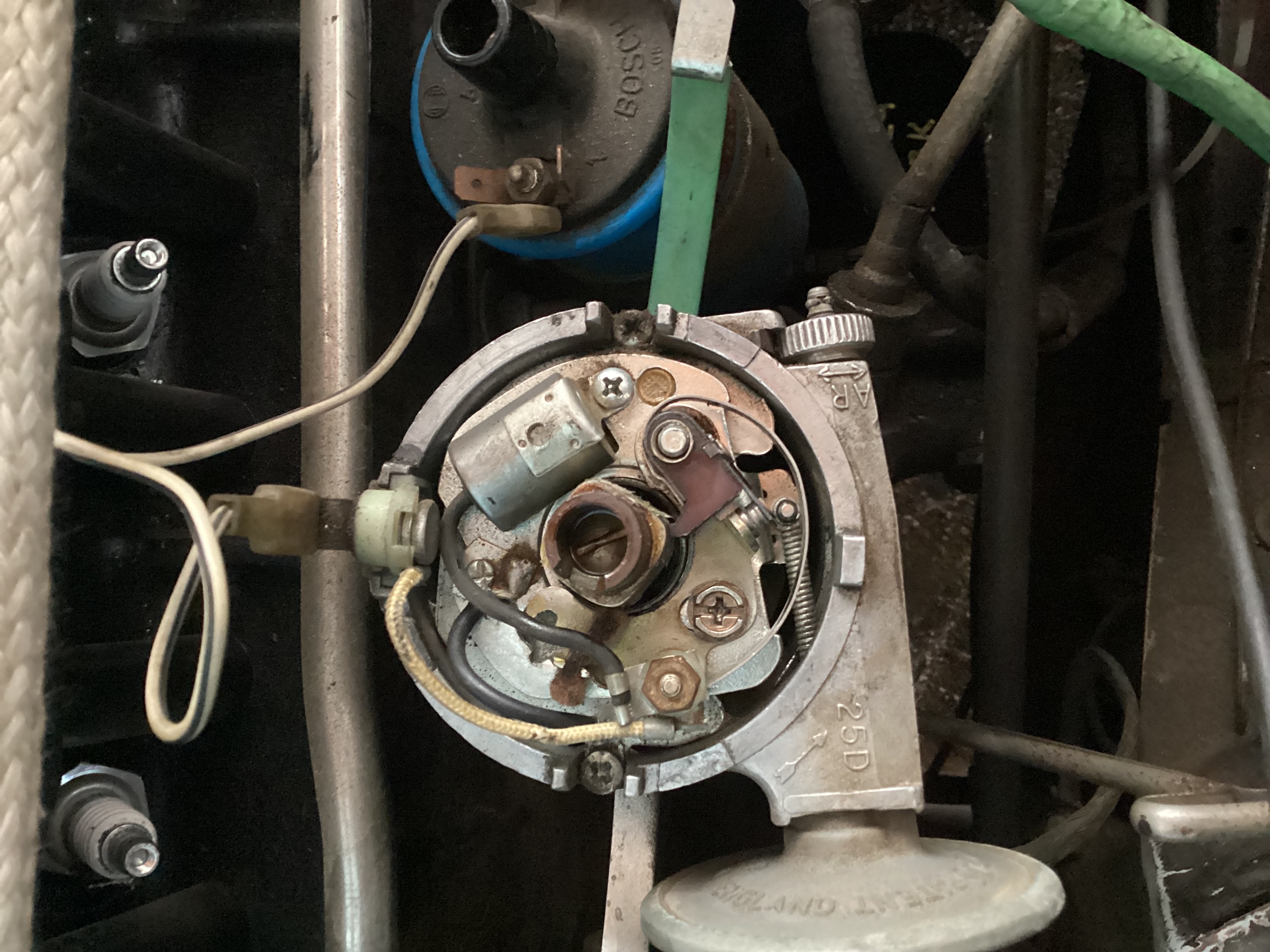

I’m a big fan of points. (Pertronix vs points discussion belongs on another thread on another day). The one thing I never liked about them though was that annoying little slot headed screw (usually with a worn useless slot) that held them to the breaker plate. A number of years ago I finally replaced mine with a new better version. You will need a standard 10/32 electrical ground screw. There are several slight variations. Get the kind with a thread chaser tip and you won’t have to retap the hole in the breaker plate, and if you get the kind with a 5/16” hex head you can use the same nut driver as you use for the nut that holds the wires to the points assy. These screws even have an integrated washer head. After you chase the new threads you’ll probably want to cut the new screw a little shorter (see picture).
A small change, but one that makes this job a little more pleasant. I was reminded of this when I stumbled upon a very interesting discussion about points in the tech tips section on the Advanced Distributors website. A good read.
