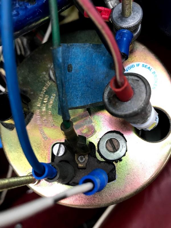

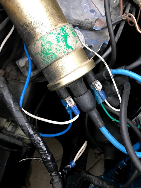

ok ive tested everything the only thing i can think of is tat its my Tach which wasnt working well. so I have a RVI tach brand new. so do i run the white ignition wire in and out of that then to the coil? or what i have done at the moment is i have the white ignition to the coil + then a blue back to the tach then a white and black wire to the coil - then the green down to the distributor.
ok i have tryed running it.
ive tryed the the white from the key throught the tach. and with it the blue to the plus of the coil and the black and white to the neg of the coil.
Ive tryed an tach i use to use, cheap generic thing from the auto parts store no luck.
