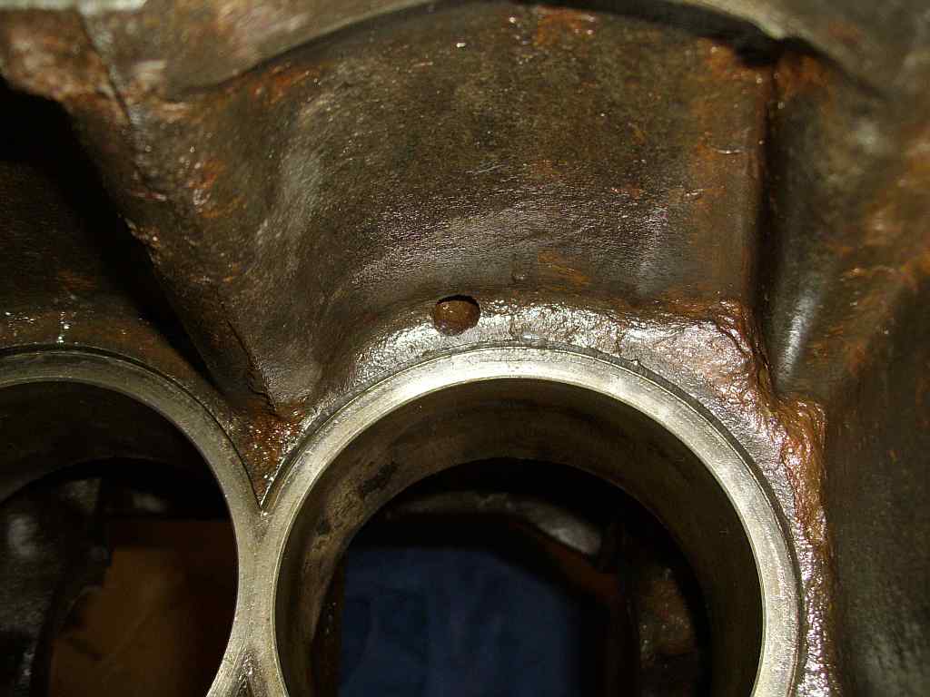

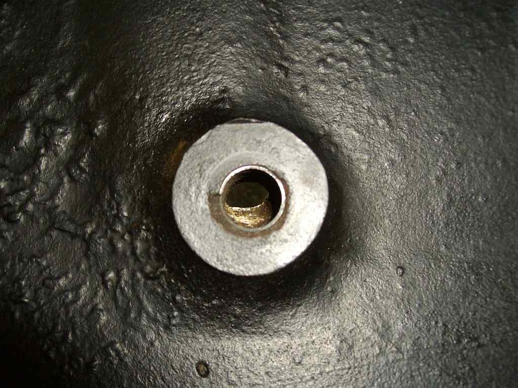

Here's two pictures of the small hole with the water tap and liners removed. Note that if you try to drill into that hole, you could hit the FO8 gasket, because it ends at that gasket. It is the lowest wet point in the block.

darn. I was hammering away with a screwdriver and hammer.I freed the blockage. I'll have to get a light and mirror and see if I did any damage. I had no idea It was that close to the liner before I read these posts but Andrew did say " gentle taps".
It's not likely you've damaged anything IMO. Those liners are pretty darn hard, not likely you'd break one with just a screwdriver & hammer; and some gouges on the outside are not likely to hurt anything.
The Fo8 gasket sits down in that machined area with the liner clamped firmly on top of it, so it would be pretty much impossible to damage the gasket without breaking the liner or (cylinder block) first.
