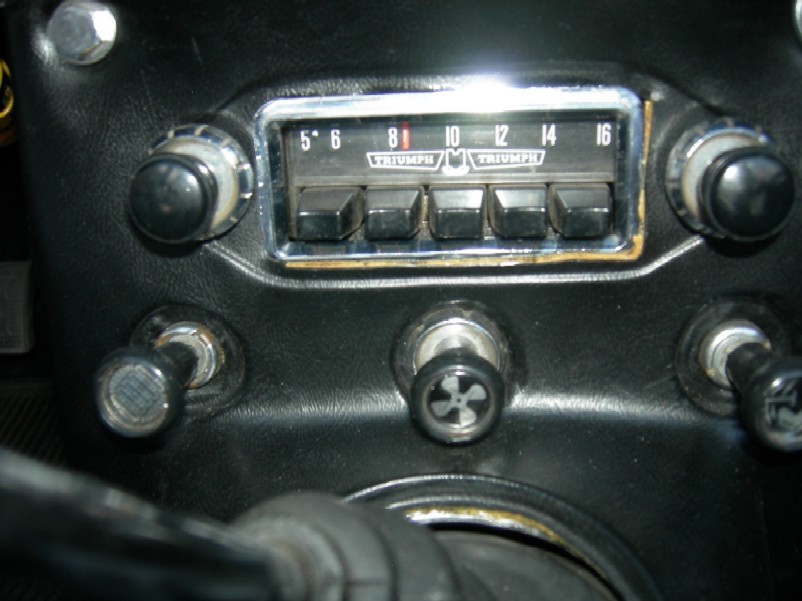

/bcforum/images/%%GRAEMLIN_URL%%/cheers.gif Well Folks; I did it! I Think??
I cut off the ears on the Chrome Plate Surround and "Crazy Glued" the Chrome Surround around the Dial: I guess I could have Centered it better but Its OK for Myself: Now; The Radio is Secure and Removable, If necessary / No Cutting into the Dash Support etc:
What do You Folks think?
I just got 3rd. Place @ "Britfest" (Bashed in Door and All):
Regards, Russ

Re: Please Help! Send Pics of TR4 A-AM Radio Insta
Hi There All;
Well; I`ve been to a couple of shows lately and have seen the way this "Bendix AM Radio" is supposed to be installed:
The Chrome "Ears" are supposed to be on the Outside of the Dash Support; Visible to the eye and just behind the Knobs:
How they get it in this position is beyond me but that`s the way It was!
Well; Close enough for Me anyway;
