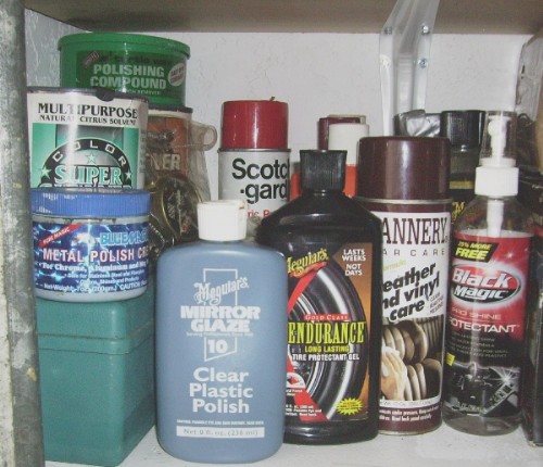

I use Meguiar's Plastic Polish #10 and if there's any scratches, I use Meguiar's Plastic Scratch Remover before the Polisher, makes my lenses like new, leaves no abrasion marks.
I tried using Metal polish, but it did leave a "cloudy" film and very fine abrasion marks on the plastic, while the Meguiar's "revived" the depth of the lens color, (whether Amber or Red or Clear), leaving it mark-free.
I got it at PepBoys, haven't seen it in other autoparts.
Ex

I too use Meguiars but in the tan bottle. (different number?) The evidently have a few plastic rehab products...
