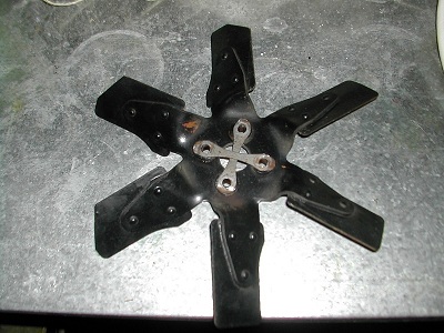

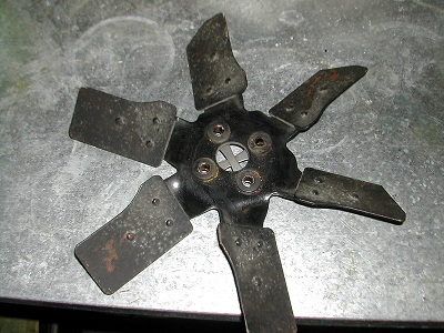

Below is a front & rear view of the fan I removed, it did have locktabs on the bolts, but the bolts went thru little rubber grommets with steel sleeves (seen in rear view) & it was wobbling on the worn rubber making a nice clunking noise at low idle, strange fan... 3 of the blades had angled reliefs, 3 didn't ... anyone recognize this fan ? wonder what it's off of ?
