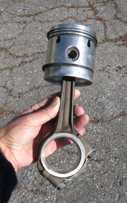

I bought my piston rings and liners as a matched kit diectly from Peter hepworth in North Yorkshire. I have 4 rings on these pistons. The racing guys like the Hepilite kits. I drove 94,000 miles and used 1 quart of 20W50 oil every 600 miles. That was the issue. In 2007, I rebiult the engine and the engine re-build shop owner whom I have known for years told me I needed to replace the rings as there had been "blow-by" pressurising the sump (oil pan) causing the oil to get forced out the down-pipe below the fuel pump.
I had him hone the bores and put in new rings I bought directly from Hastings in Michigan. Since then I have been using Castrol 10W30 for 11,000 miles and have never needed to top up any oil between oil changes (3000 miles) during four summers of driving.
I am very pleased and since it was mu friendly neighbour you assembled the engine for me, I can only assume that the bores of the liners had not been honed before assembly in 1989.

Tom - I believe that my original pistons had three rings as all TRs left the factory like that. When I was doing the restoration of my 1958 TR3A from 1987 to 1990, I wanted to keep everything "as original" and the only set I could find with the original bore (1991 cc) was the kit from Hepolite and these pistons happen to have 4 rings. When I spoke to Peter Hepworth himself, he told me that he thought he could find a set (his last set for 1991 cc) down in the basement and that I should call him back the next day. I did and the deal was done. When I got the set, the rings happened to have 4 rings per piston.
The piston you see above is one of that set with zero wear after 94,000 miles on them. The rings are from the new Hastings kit. Yes, that piston and the others have been cleaned a bit. The bores of the liners were worn with a slight wear taper of 0,0005" from end to end - virtually like new. Since my neighbour put it all together, he was very careful and balanced each set of pistons and con-rods to have equal weights. But I was in the Far East on business for three weeks and never noticed if the liners had been honed or not.
At 94,000 miles, I too rotated the liners 90 degrees because the side to side force of the pistons and con-rods would now be running in the areas in the bores where there would be no-wear. I've been pleased with the results I have had for the last 3 summers (11,000 miles) with Castrol 10W30 and 4 oz. of ZDDP per oil change.
