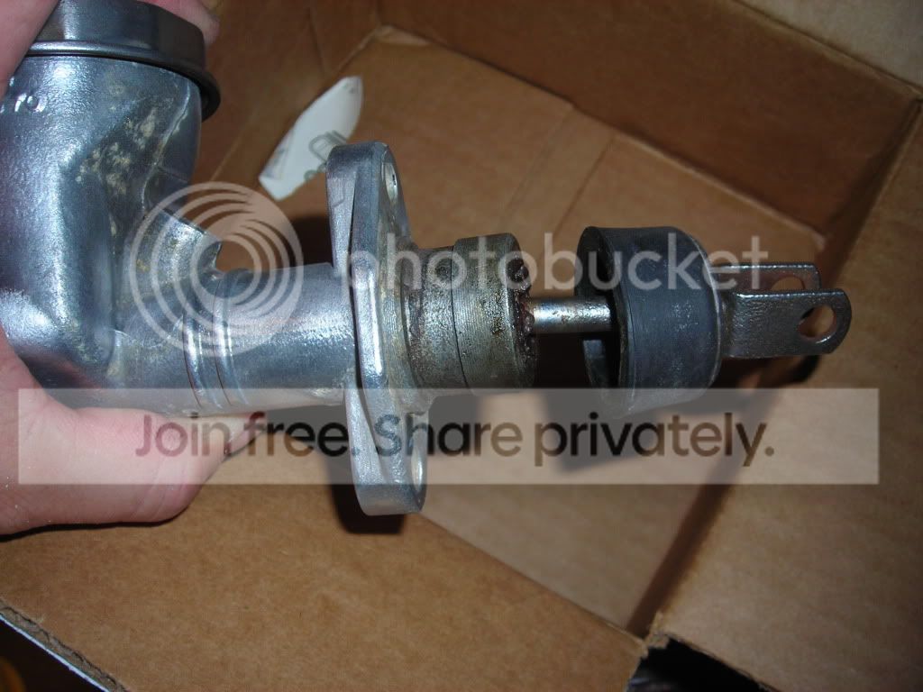

Here is my replacement brake M/C for the TR4A as it came. It had sat for a long time but the seller (nice guy) cleaned it up a little for before sending it along. You'll note that this unit has two exterior rings on it, which indicated that is has a .7 bore where as a single ring indicates a .75 bore. You'll need to confirm which you have before ordering replacement parts.

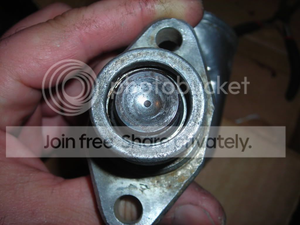

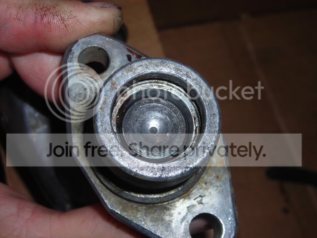

You first peal back the rubber boot so you can access the circlip that hold the push rod and inner assembly in place;

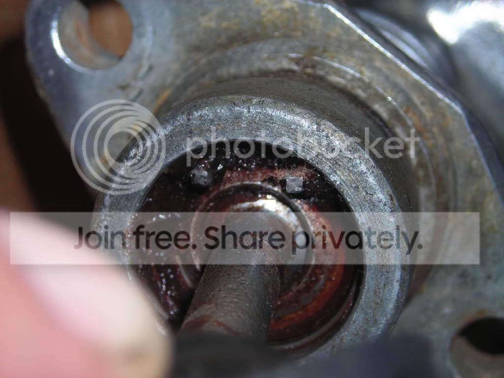

Expect to see some junk here that needs to be cleaned up;

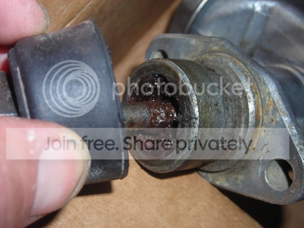

Once you compress the circlips the push rod will come right out and you'll remove the following;

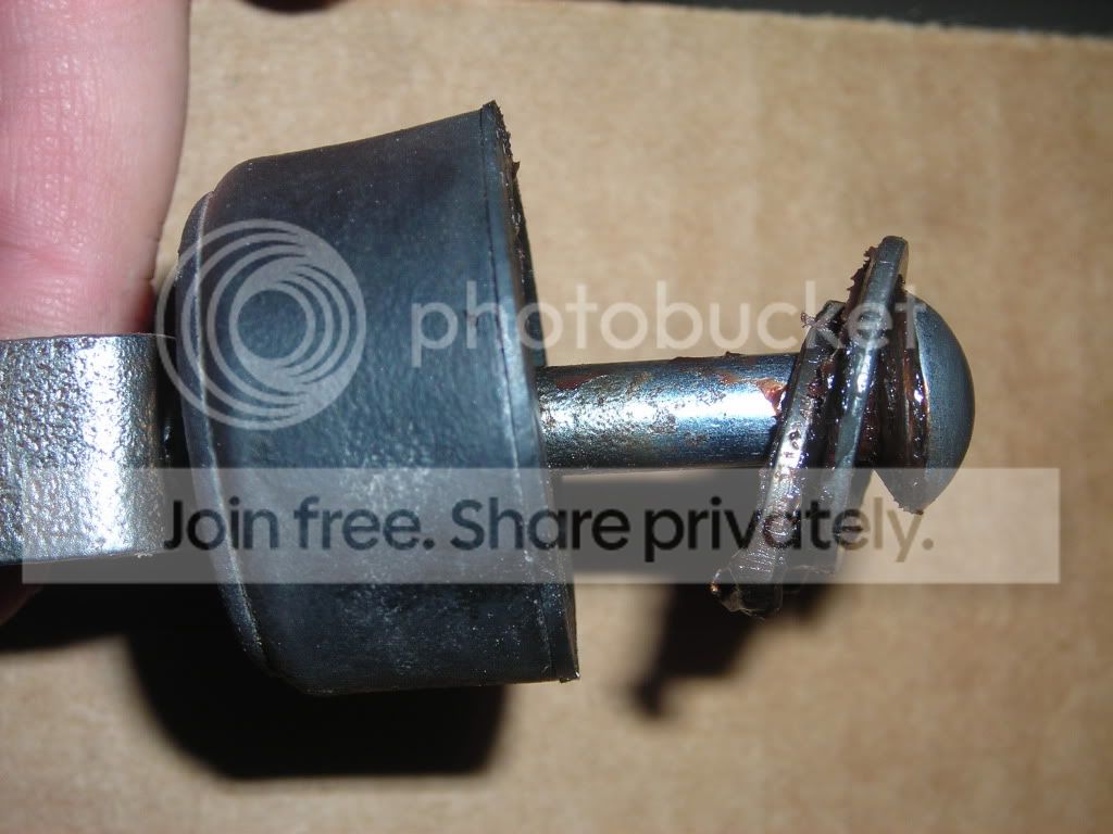

Here is the assembly that comes out. We'll be replacing the rubber seals.

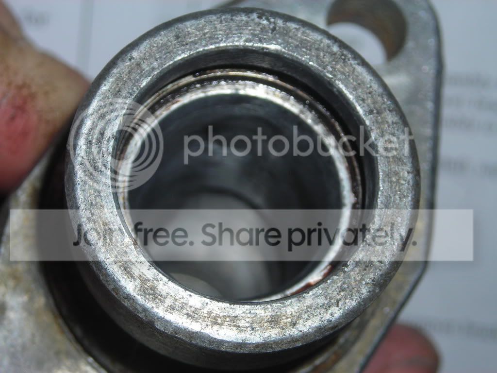

And this is what the bore looks like, more more accurately what you bore might look like but hope that it doesn't. It was hard to get the camera to focus on the inside of the bore but if you look you can see a dark ridge about 1/3 down the bore. That is pitting, nasty pitting actually, and this unit will need to be re-sleeved since honing it won't work.
It is still worth holding on to as a core since it can be resleeved for around $80 where-as a new one is over $160 froms Moss.
