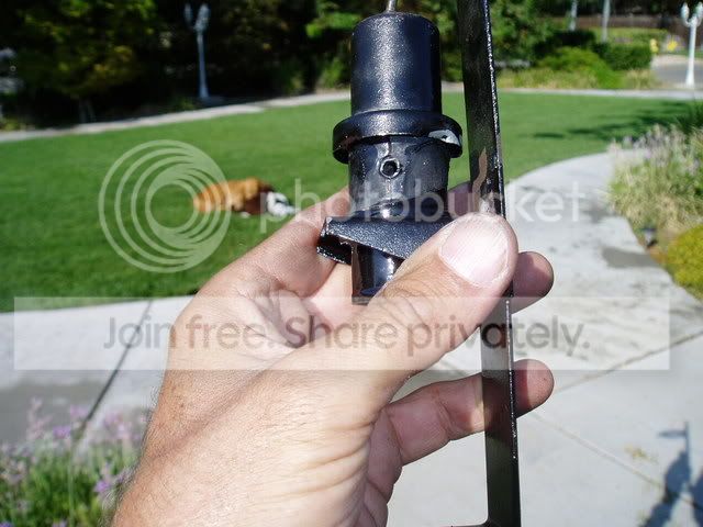

I drilled the hole out on the valve and tapped some
threads in and screwed in a brass nipple and reattached
the hose. Pics follow and I hope this repair works.

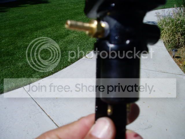

Pic of valve with broken nipple ground off completely:
Pic of valve with new brass nipple installed:
Sorry for pic quality

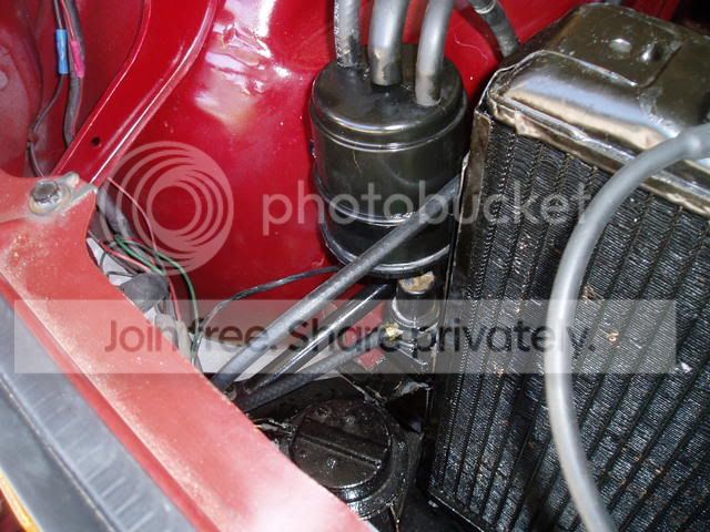

and now pic of the unit reinstalled:
