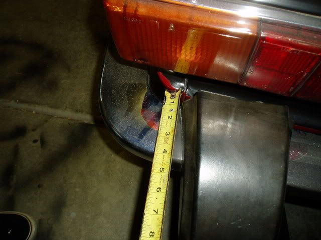

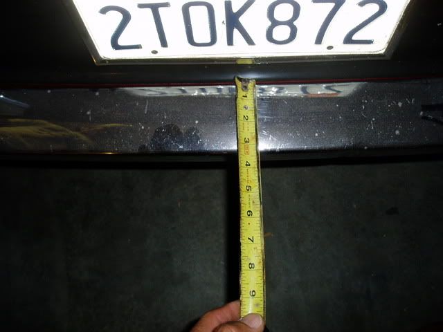

Picture is poor. Tape reads approximately 1/4 inch gap accross bumper from center line to just inside the rubber
bumpers as follows:
and

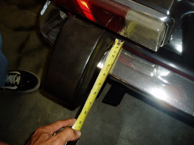

Then as you move to the outside of the bumper going
around the corner, you're looking at right about
1 inch, laying the tape as follows:
Hope I've helped ya, Ray
69-74 & 74.5-76 use different rear bumper brackets. On the later cars the rear bumper sits higher than earlier cars. Not sure of the clearance from the valance to the bumper but check the measurements with a similar model year.
Thanks 2wrench. Seems your bumper, even though a '74, exhibits the same variation in gap between the center and ends as mine. So now I can stop worrying about it and move on.
