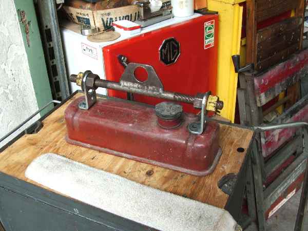

I can't quite tell from the photos, where did you attach the lift brackets? Are the lift brackets "standard"?
Front bracket attached to the top water pump bolt, back bracket to the rear-most manifold stud. The brackets came with the engine leveler that I bought when I bought the engine hoist.
When I pulled the engine out of the midget, I used the valve cover studs, and bent one of them. This time, I used more secure bolts and everything came out just fine, no damage.
If you use the right gizmo the rocker studs are the "factory" way. We fabbed this one up using the illustration of it from the Bentley book's "tools" section. Back in 1970, IIRC. It has yanked a LOT of BMC engines over the years, just replaced the "legs" and haven't yet used that set. But the day will come, certes. :wink:
Dat looks like FRANKENSTEIN.
sheesh. I'll take a spray-bomb to it.
...you're just jealous, Pat. :jester:
