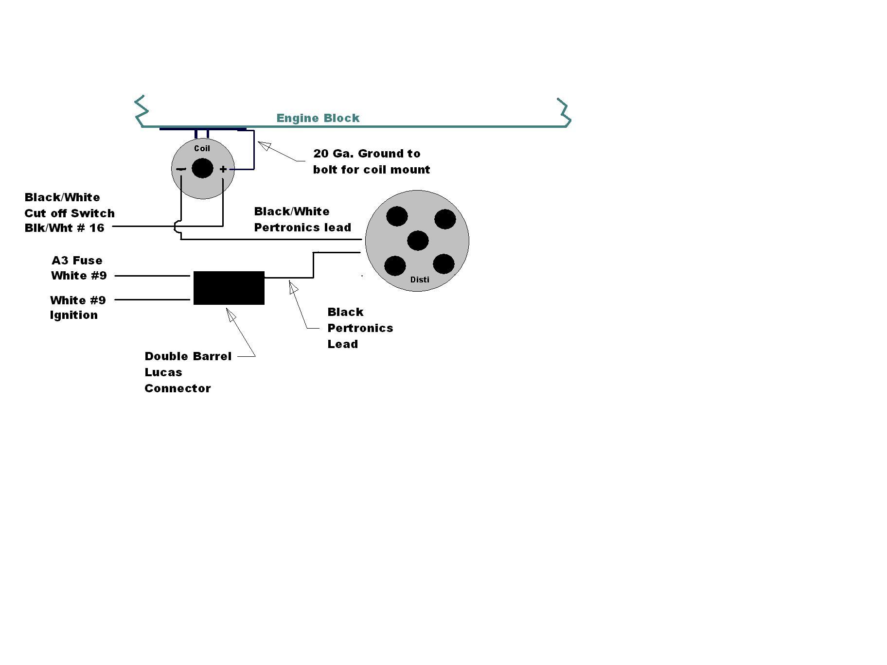

I think you should stick with the Pertonix. Given all the time you have spent trying to get the car started it is understandable that the poor Pertronix just got cooked.
As you know the unit's one weakness is that it doesn't like to be energized for long without the car running. To minimize exposing the Pertronix to overheating while adjusting timing I get everything set up, loosen the timing pinch bolt, start the engine and adjust advance as necessary, then shut down and retighten.

This was a good move that ground must be inplsce irregardless of the ignition system in use.
