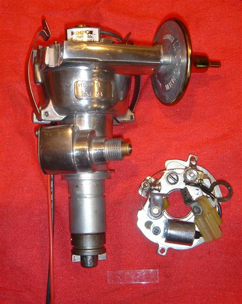

Don, I have three distributors that I swap around when I'm bored. All are rebuilt by Jeff, two have points and they have three slightly different curves. The best match up for my new engine seems to be the Pertronix, but that curve is almost identical to the last points distributor that Jeff did for me.
I sent the details of the engine build to Jeff along with the distributor and he matched it up to that and installed the Pertronix at the same time. I have a breaker plate ready to drop in that has a set of points/condenser on it, all set to go, should there be a problem. Jeff set this up when he did the Pert distributor as a back up.
