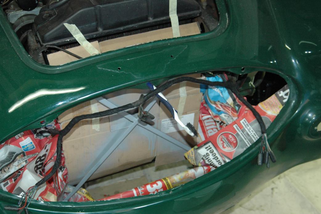

Jeff,
If I am not misunderstanding your request, I don’t believe you can buy just a harness covering for application to an in-place harness. Way back when, Rhode Island Wire re-rapped my original harness. As I remember, they cover a harness by spinning the covering over the wire groups. For a complete harness, they build the wire portion of the harness and then, as in my case, spin the material covering over. The result is a seamless harness covering and something that can not be applied to in-place wire groups as you can with a vinyl tape.

You're correct on this Ray. I've used Rhode Island Wiring Service earlier this year to do two harness sections for my BJ8. They have the correct loom material and tracer patterns to match the originals. Price and turn around was very reasonable. Service was excellent. I repaired two sections and sent them to them. Best to call to talk to them before you do it so you know how to mark the harnesses because they need to know where to stop the braiding.
Hi-Fi geeks use it for decoration of speaker wires. I was looking for some braid to recover the original main battery cable a while ago but it really isn't practical as the braid is machine-wound over the cable rather than applied as a sleeve. I think the results won't look very good for repairing original wires as the braid will stay baggy rather than clinging to the individual wires.
