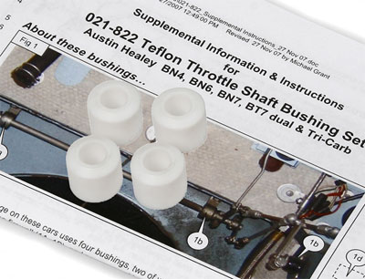

The first place I'd look into is the throttle linkage bushings. Moss motors sells a Teflon replacement set. Here's their write-up:
Teflon not only has a longer life than the original materials, it flexes less so your throttle reacts as fast as your foot hits the go-fast pedal. If your throttle linkage is loose or sluggish, it's probably because your original bushings have disintegrated. Replace the original felt or rubber/brass bushings with our Teflon upgrades. Fully illustrated installation instructions are included.
