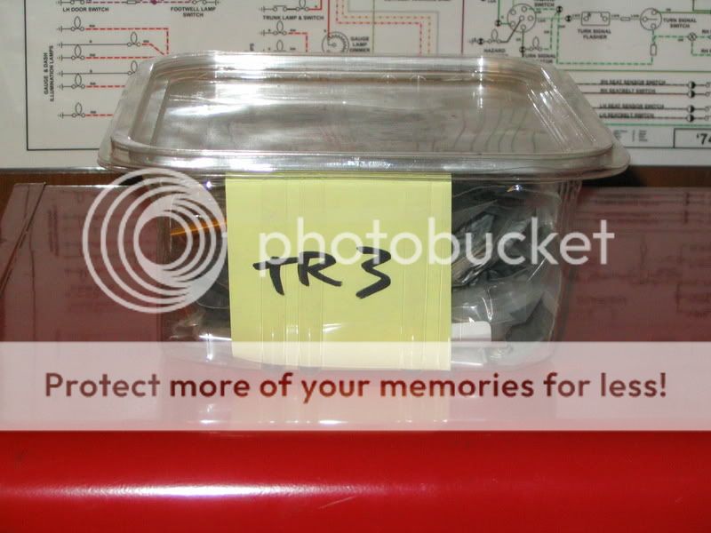

I'm w/ Paul on the plastic tubs, except I use the kind my wife buys salad in;
Many different sizes, and they're free! I used to keep stuff in the cardboard boxes they came in, but too hard to find stuff...

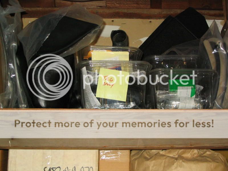

My approach is a little different, but only a little ... I buy large plastic crates at HD or Costco (the Costco ones are better made) and then pile things into them roughly according to pages in the Spare Parts Catalogue. Obviously that doesn't apply to large parts, like transmissions and cylinder heads, but anything small enough for a crate goes in a crate. If necessary I further subdivide along logical lines; eg "lamps" in one crate and the remainder of "electrical" in another.
Then many smaller items get grouped together in baggies inside the crates, like TR3 dash switches all go in one baggie. Here's part of my stash, on some neat shelves that I snagged when a previous employer closed their sonar business.
