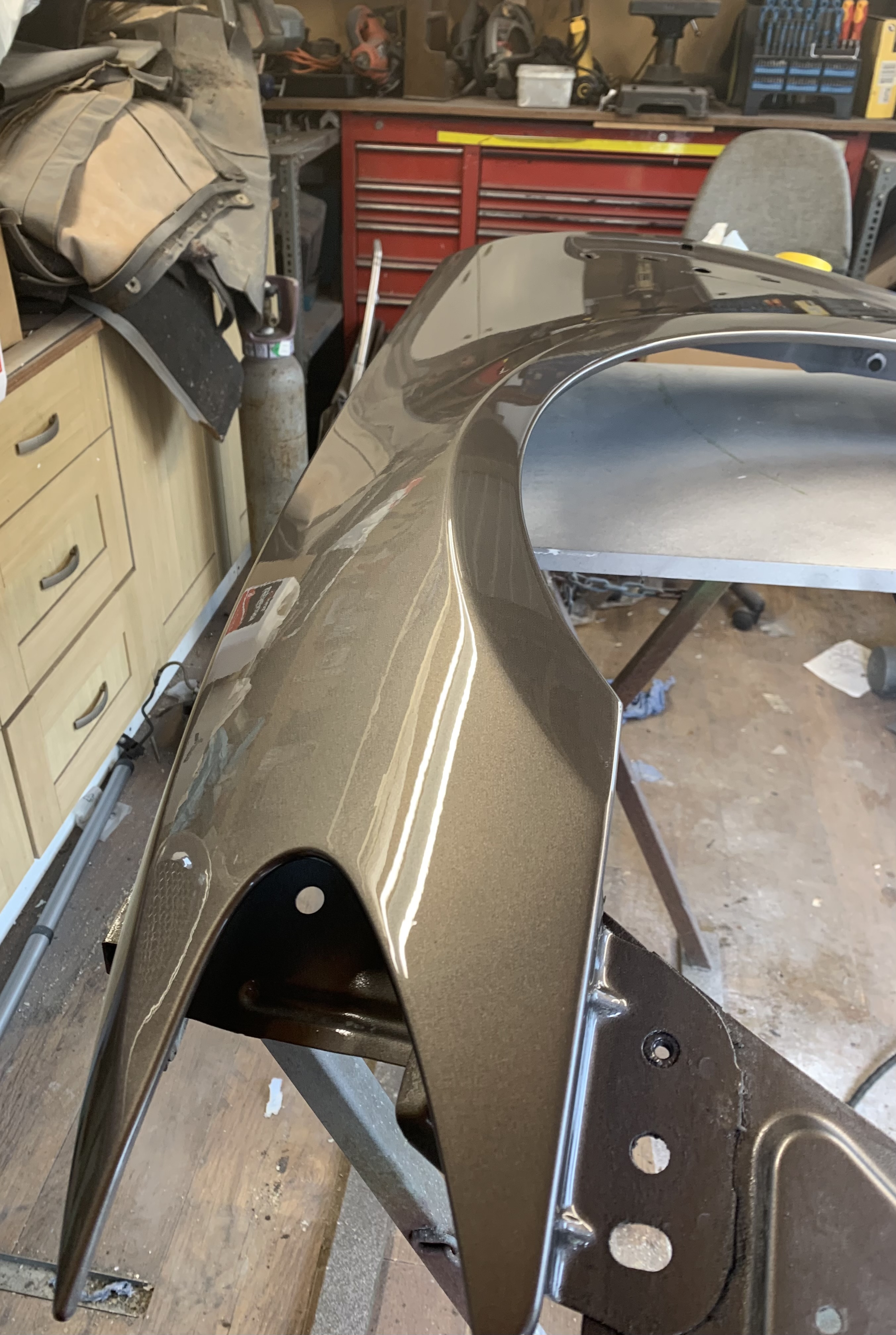

Re rusted and first wing painted. Fresh out the gun.
the colour is lunar grey
I used a spirit base base coat, followed by 2K clearcoat.

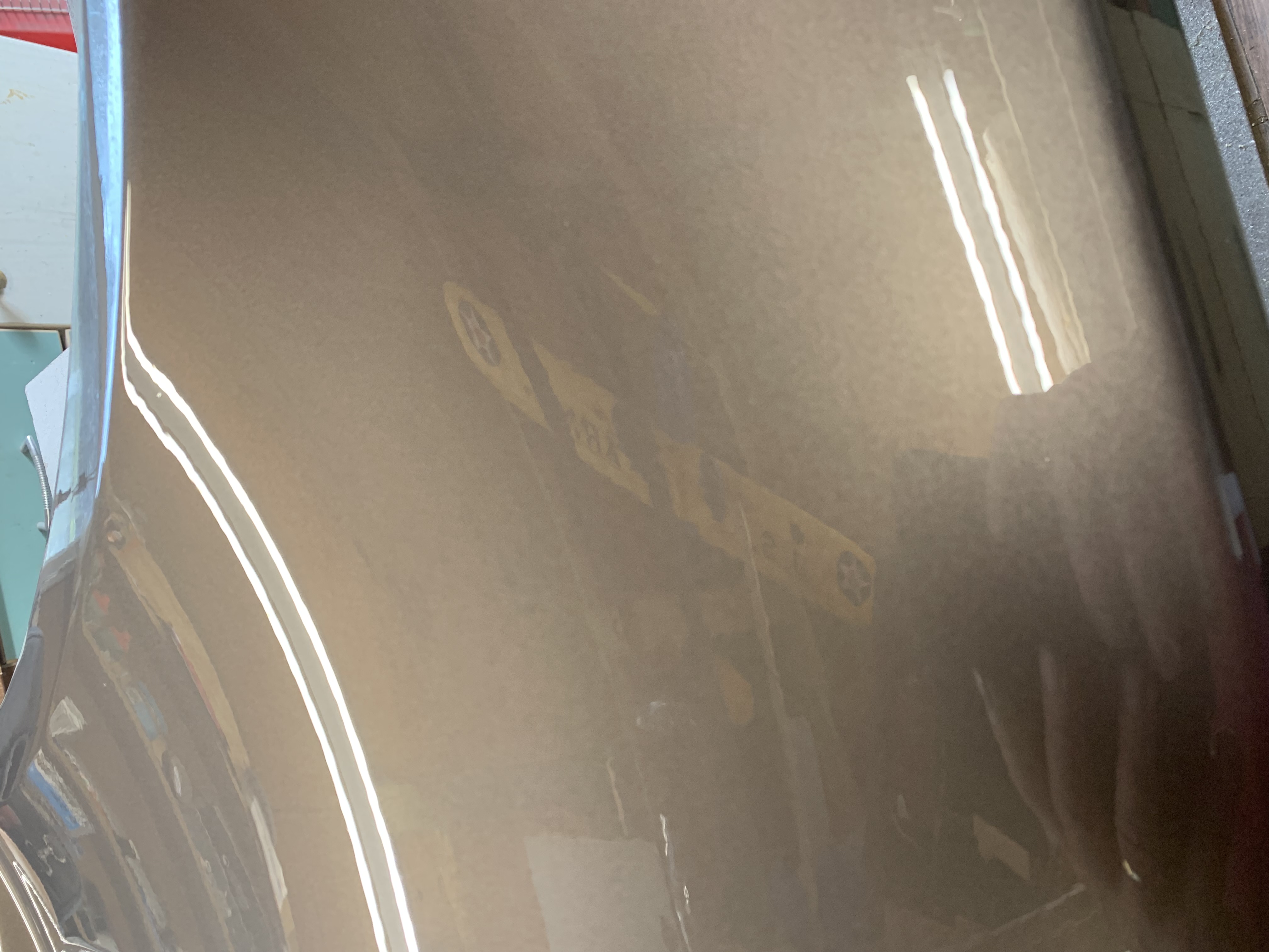

I always put an extra coat on for the mop. especialy when i cant spray in a booth, allows for a bit of rubbing down to get all the nibs off.
plus the extra coat when applied dirrectly on top of the previous coat lies flatter,
In a booth when it is baked you dont need the extra coat as it flattens as it heats up.
"Lechler" was the brand name of both base and clear coats,
I already had 10 ltr of clearcoat so only needed to buy the base from a local supplier,
it was not water base, takes too long to dry outside of the boothe, as it requires a lot of warm airflow over it to dry, this doesnt happen very well
outside as the last thing you want is all the crap in the wind contaminating the paint, where spirit base evaporates quickly in a warm environment
without airflow so gives it less chance to get contaminated.
There are restrictions here in the UK, if you use over a certain tonnage of paint then you have to use water base.
so mr joe bloggs like me is ok to use sirit base.

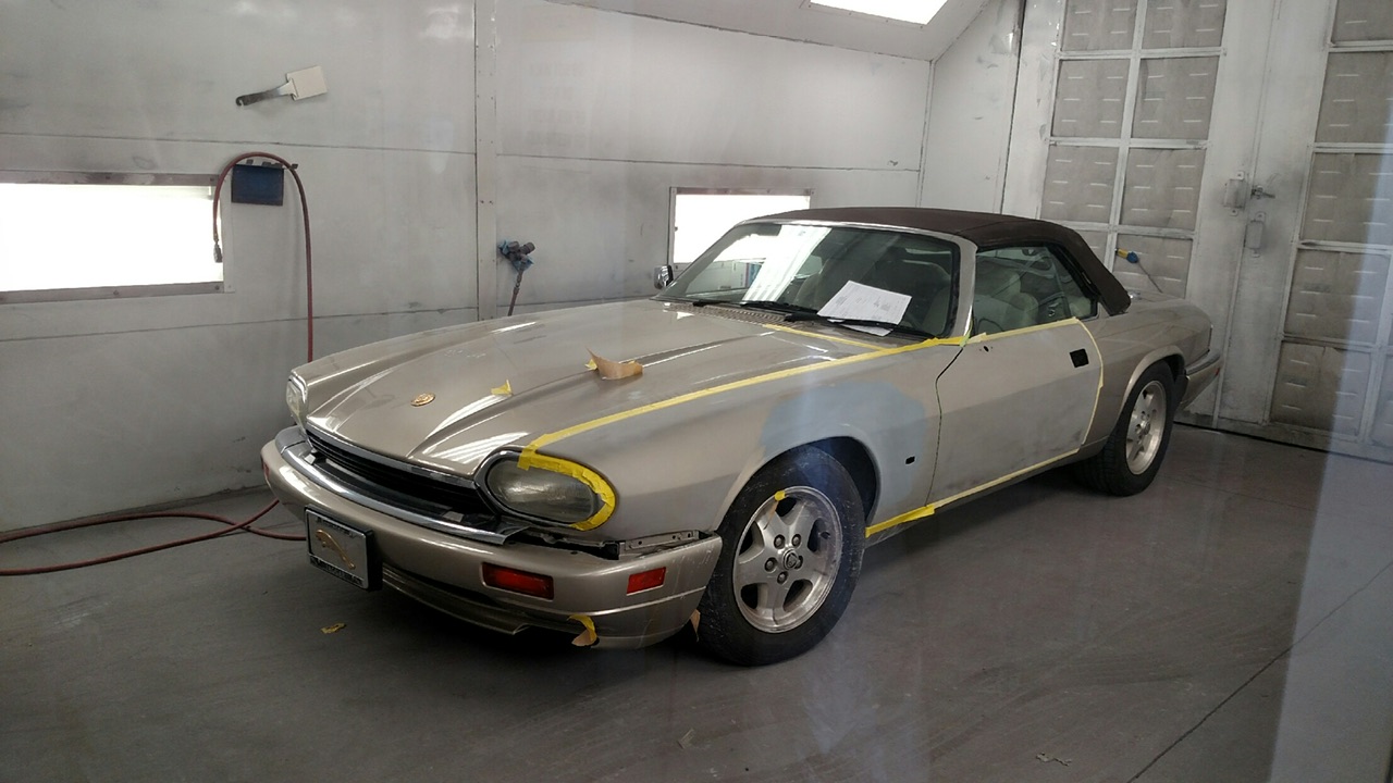

I know a good Jag painter in Tucson AZ!

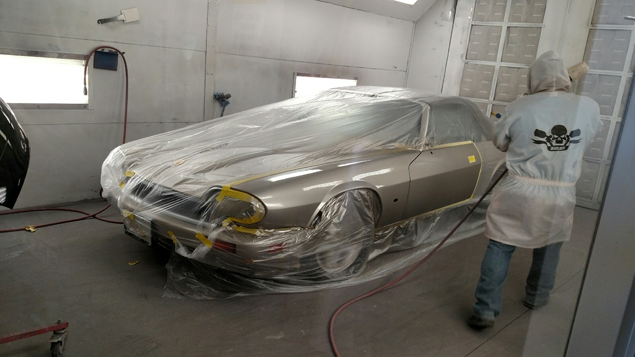

He knows what he is doing, Blending into the door,
no colour match is perfect, blending is a must do, never go edge to edge with paintwork.
