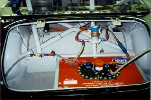

Question, I don't see where you made any provisions for the fuel cell in th trunk, almost everybody cut a hole in the trunk floor to lower the mounting position of the fule cell and lower the CG of it's weight, like this. What I normally do when building a race car is pretty much mount everything that's going onto the car, except maybe wiring and some plumbing before paint, that way I don't discover post paint, I need to cut something or add a weld-on bracket somewhere. I always tell people to build a race car you've got to build it twice, once before paint and again after paint, I can tell you from years of experience and doing this many times, it causes alot less headaches in the long run.

I actually have a plan for exactly that. One that should only disturb the paint under the car more so than the inside of the trunk. I really wanted to get that done before I painted last weekend but I ran out of time and I need to get this spray booth out of the garage.
But it is funny that you point that out, That was the one thing I was upset I didnt get to do yet.
Oh nope. I did forget to drill to 3/16" inspection holes. So taht't require some toch up as well.

You can pull off post paint, one way would be to drill holes in the trunk floor and use a skil saw to cut the hole, this work better post paint because you don't create any spry like you would with a cutting disc. There's also different way to make structure to hold your cell in place, I made one time on a car that already had been paint with aluminum sheet metal, about .100" thick with 90 degree brakes in it, it turned out to be really strong, so they are plenty of ways you can do this post paint with positive results. If you ever want to pick my mind, just give me a shout, and we can brainstorm together.
I have a thought that I think will work well. I will let you know how it turns out. Skil saw may be an option too. Hadnt thought of that.
