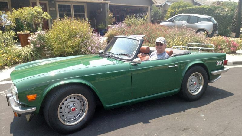

So I recently finished up my restoration on my TR6, and I painted it myself in the garage.
Best to have some spare sheet metal and try out the gun settings. I purchased 3 cheap fenders for a Honda.
Most gunners I talked to have the fan wide open and then set the flow so that at about 12", the paint is fine droplets. That is with a stationary gun with a one second pull on the trigger. Make sure you have the required pressure at the gun as dictated by the paint manufacturer. Make sure you have the correct reducer for the spray temperature. I had a difficult time when I started with gun movement....but got the hang of it when I was done.
Expect to spend a HUGE amount of time in the cutting and buffing.
Cheers,
