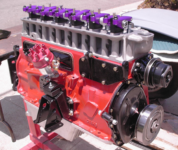

I went with “Universal Red” engine paint from a local auto parts store. I can’t comment on the longevity at this point, but the paint is easily obtainable for touch-ups. Here’s what it looks like.
I don't wanna touch up! LOL! I want it to stick like glue. Fading is bad, but cracking is worse. I've used Duplicolor in the past with good results. I may go that route. I want to use the Eastwood stuff but they don't have a regular red, only Ford red.
