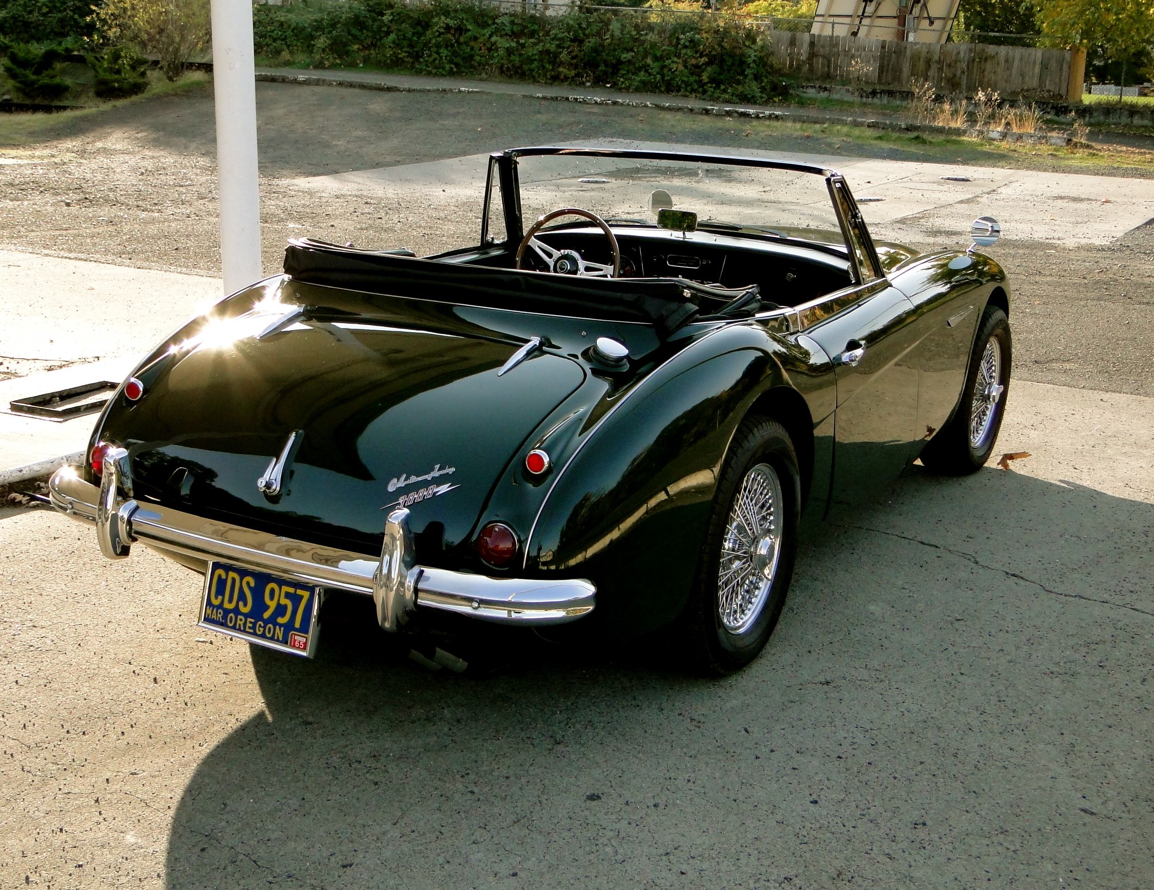

Dougie. of the two BRGs on Healeys I like the GN29 Dark BRG best. The light green just looks off to me with that yellow tint. Your car shows GN29 at its best. Beautiful!
