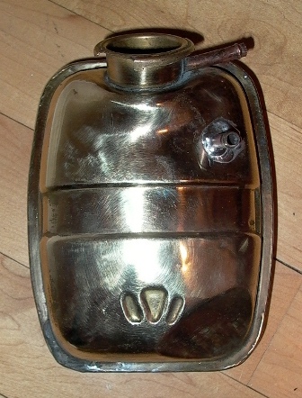

FWIW I took the paint off my overflow tank - polish and clear coat - looks distinctive

J-P - How'd you get all the paint off that tank? chemical stripper, rotary stripper, wire wheel, etc.? And of course, any picture of the final result would be appreciated!

overflow tanks are smaller than the whole rad, but, repair, paint stripper, steel wool, polish and now, waiting for clear coat.
