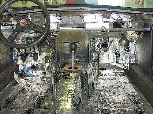

I just got done installing Dynamat in my MGB/GT. Great for keeping temperatures and sound levels down inside the cockpit.
Looks really nice Rick. This is SOP for me as it makes a big difference in how solid the car feels and generally makes it a more pleasant place to be.
