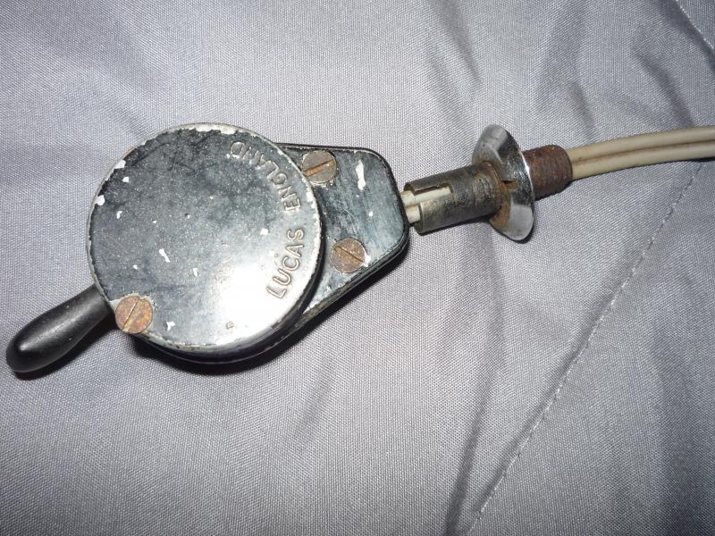

I recently had a Tr6 type A , OD installed in my 60 TR3A.
it is working very well. However, the egg shaped OD switch is loose on its shaft.
It rotates freely and will pull straight out of the cylinder shaft mount (pulling wires & all).
The mount (thru the dash) itself seems fine. But I'm hopeful someone can tell me how to snug the egg shaped body down.

Aloha Guy,
Here is a picture of an original switch. The slot on the mounting tube has a slot that engages a tab inside the switch. That keeps it from orating, but other that the friction of the tube, it can still be pulled straight out. Maybe you can open up the switch and refurbish the tab (or create a new one from JB Weld!)
Where in Chapin are you at? I get back to Columbia a few times a year and have a 59 TR3A in storage.
Jeff
74.5 TR6
I drove for a lot of years with a piece of cardboard in that joint, for just that reason. Remove the 3 screws visible in Jeff's photo, and split the halves apart. Then bend or fill as necessary, so the tube gets clamped firmly when you put the halves back together.

thanks is for all the input! I guess it's good to know that it's the switch design that needs work & not just mine.
Rotated the shaft where the slots are correct . Then i dug around and found a slit rubber grommet that I'm sliding over the wires at the back of the mount, behind the dash, a spot of silicone adhesive, and that should hold it.

Hi Guy,
I had the same problem. Open it up and use two sided sticky tape wrapped around the shaft. Mine has held for two years so far.
Steve
