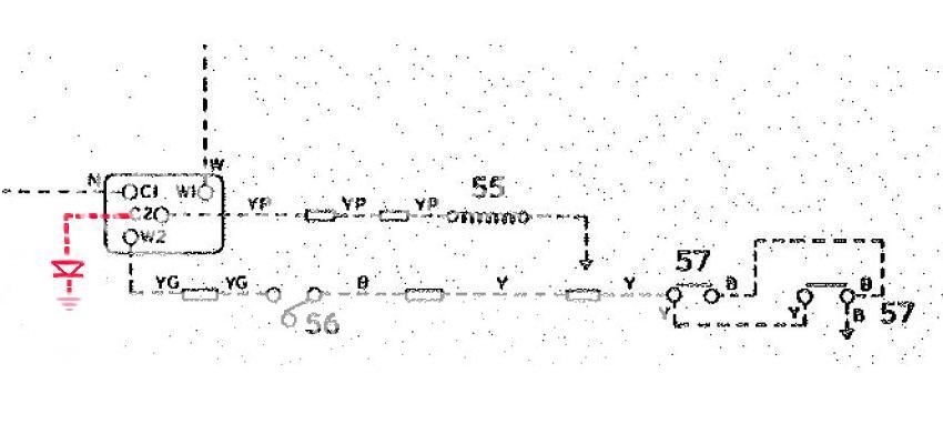

I used a diode as suggested above by Randall. This one:

On my positive ground TR4 I attached it at the relay thusly:

1. what is the diode part number (a little hard to read 276-1661 or 1861?). For Neg ground do you just reverse the diode?
2.What benefit do you get from the diode?

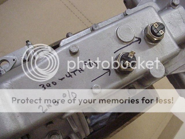

3.What do the transmission isolator switches (#57 in your schematic) do? I had assumed that they were 3rd/fourth gear enabled but mine do not seem to have any continuity between the terminals no matter what gear is selected. The manual is no help here.

I am not the electronics expert here - I'm better at recognizing a good idea than actually having them. That said:
1. P/n is 267-1661. Yes, reverse the diode for negative ground (I think that is what Randall's schematic shows).
2. I've always called it a snubber diode but apparently flyback is also a term. Wikipedia entry here.
3. Those isolators provide a groundpath for the solenoid only when an appropriate gear is selected. On an A Type - one for 3rd or 4th and one for 2nd.
ODTop_zps94c20774.jpg~original
The isolators can be adjusted for depth to make them work as intended. Sounds like your either need adjustment or have failed altogether.
