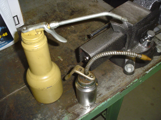

See attached and get the larger one of these to fill the gearbox/OD through the plug.
You are a genius, Harry! I have been using a syringe and tube to make a mess with. I have one of these sitting in my shop, wondering what I could use it for. Made my day.
Bill
