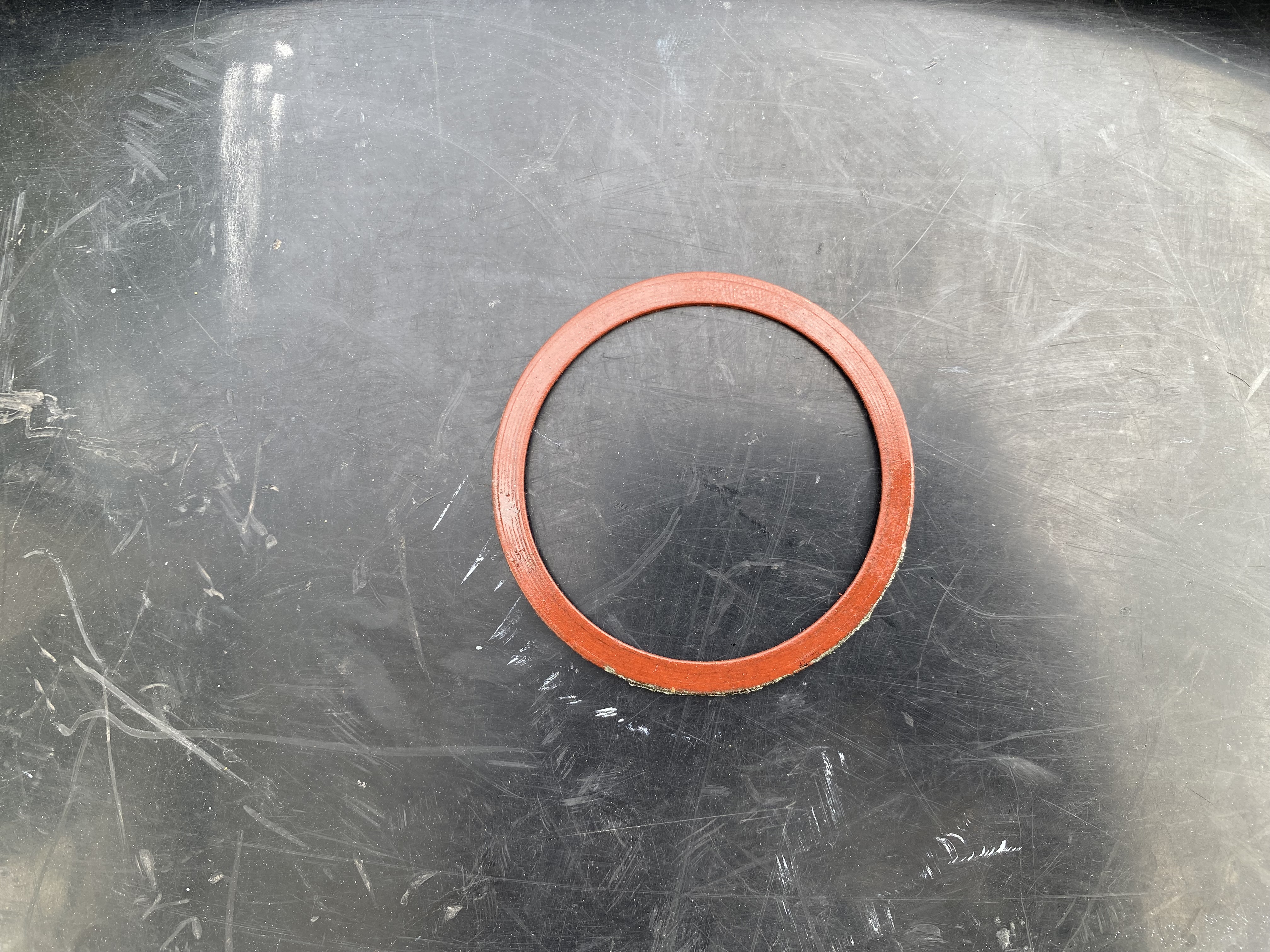

Changed my gearbox oil today and realized when I drained the old oil that the brass drain plug washer for the overdrive was at the bottom. I hadn’t reinstalled it. Will I lose all the fresh gearbox oil when I take the brass drain plug off again? Filter was clogged and there was a lot of sludge.

You will lose a lot of it, but not all. You could make sure the case area is clean and drain it into a very clean container. Or, chalk it up to a lesson learned.

Is the wash copper or fiber?

Fiber washers are usually discarded after one use whereas copper crush washers can be reused, and annealing softens them to provide a good seal and prevent loosening.
The washer pictured in your first post looks like copper but you'll definitely determine whether or not it is fiber when you hit it with the torch! :smile:

Whoa, Nellie! I've never seen anything BUT fiber washers on the O/D drain plug. That is almost certainly a fiber washer in the photo, it won't take kindly to annealing. Maybe you're thinking of the engine pan plug? Also, though I'm a big fan of safety wiring, there's no provision for it on the O/D plug and, though you could drill a hole in one of the plug 'ears' I don't know where you could anchor it.

The sludge was mostly in the screen, magnet washers and the inside of the brass plug. Soaked them in gas and used a tooth brush to go over them. Seemed to be some sediment in the used motor oil pan when I poured the used gearbox oil into the container. I was thinking of using the new oil, once I drain the gearbox, over again. It sounds like it’s better to use that as a flush. I had a hard time finding 40 sae conventional non-detergent oil. Ending up going with Pure Guard. It’s definitely a fiber washer so it looks like I can’t use it again. If I used permatex could I use it again? Appreciate the advice. Ed
I've tried all manner of goops to get a seal on the O/D plug; best results have come from Permatex Seal&Lock, but I'm still leaking. I may have a non-flat surface or, gawd forbid, a crack in the flange, and I'm not happy with the newer fiber gaskets. I just remembered Michael O. has a source for copper crush washers; I'll have to look it up.
