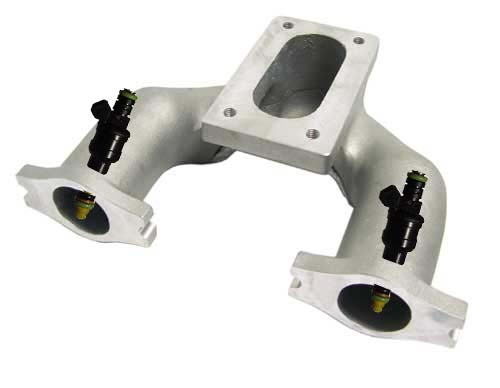

Not going the Patton route or using TBI injectors. Their spray pattern is too course IMO so I'll use two big port injectors. I'll be using the Su's as throttle bodies.
Here is a quick, rough, photoshop of one of the ideas I'd had.
JACK
Which, as it turns out, is almost exactly how the Mini Cooper MPI system is designed.
JACK
I think they may be a bit too deep in that pic. All the injected manifolds I have here they sit out of the air stream.
IIWM, I'd put them in the bend shooting straight down the intake on an A series.
