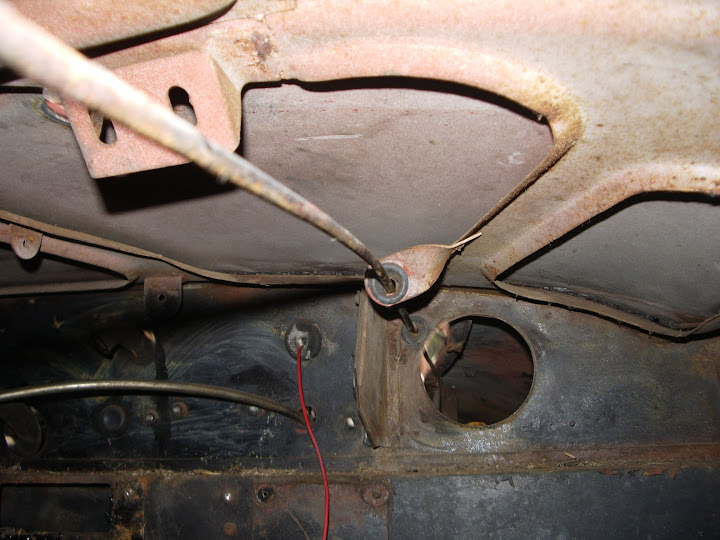

This is what I'd imagine mine originally looked like under the dash if this car was black in this pic

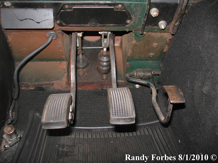

Another pic from Randy showing a rather casual painting and possibly a light brown primer.

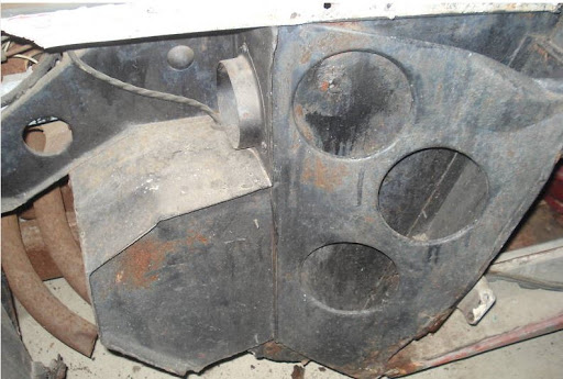

This is the underside of my front shroud, notice the casual blue overspray at the top of the pic

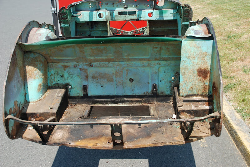

And the rear shroud, notice the blue paint dribbles around the boot edge. The car was never resprayed in blue as far as I can tell, only two resprays in white. the orange primer is a later addition.

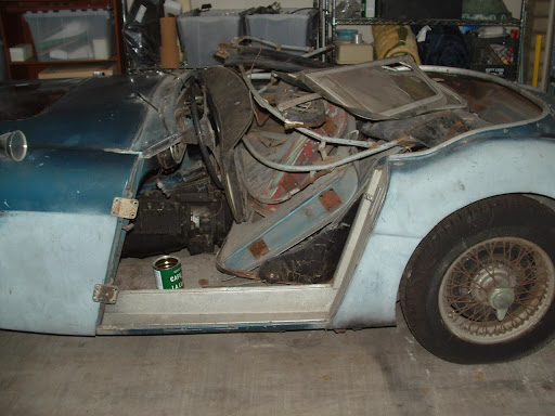

This is what I imagine my car looked like originally under the guards although it looks here to have been hosed with black as well, perhaps supporting my above theory.
