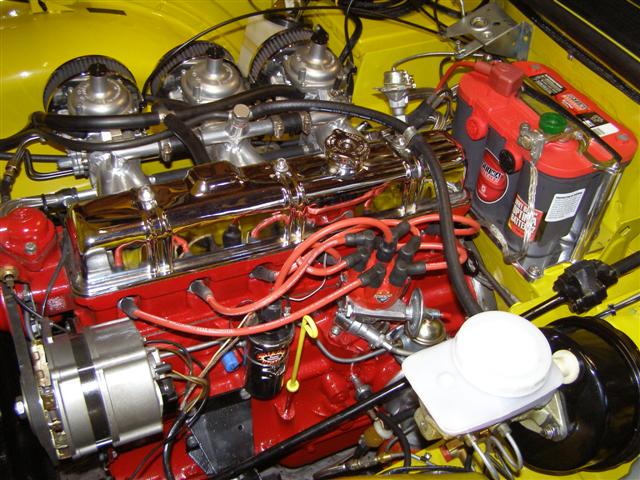

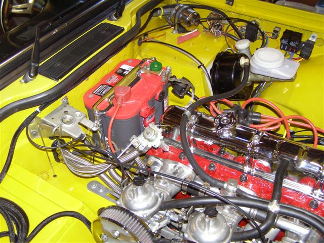

Do yourself a favor and get one of the mounts made for an Optima battery. It will hold it down well and add a little bling to the engine compartment. I also got a pulse style charger that was made for the Optima and sits on mine whenever it's not in use, which is a lot since I have the TR8 that I've been playing with.
Yeah, those are really trick. Almost enough to convince me to get an Optima!
I got mine from Summit, but many others carry them now that didn't back then.

Frank, we need Paul to post a warning before he post pics!
