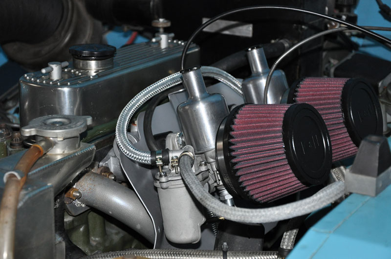

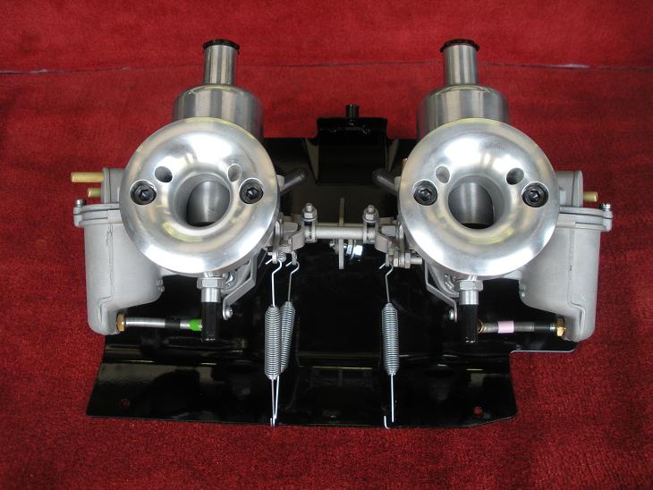

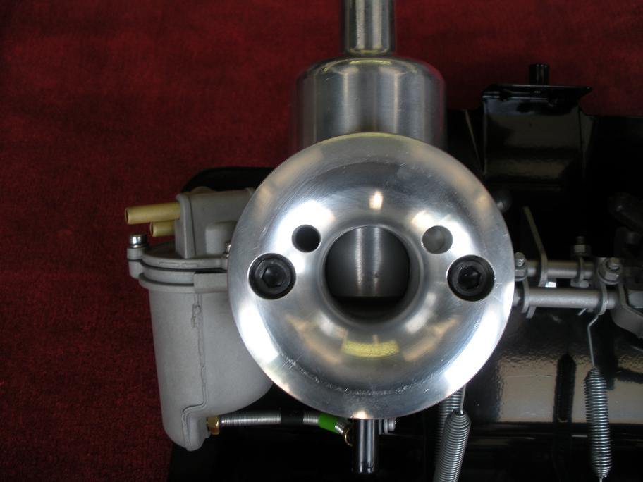

<div class="ubbcode-block"><div class="ubbcode-header">Quote:]Hi could i have a part number for the K and N filters on Gundys car please Tony[/QUOTE]
Hi Tony, welcome to the BCF!
What you need to know is that just getting a pair of those K&N's won't do the whole thing, other parts are needed to mate them to a pair of HS2 carbs.
They are designed to fit over velocity stacks with the right outer diameter and depth.
Hap Waldrop has produced some of them for the HS2.
If you are using and HS4 or HIF4 carb with the 1.5 inch intake then you can use the velocity stack from a stock MGB carb setup, the ones that are inside the stock filter cans and are connected to the fronts of the carbs.
It's best to counter sink the fasteners for this.
I did some searching and found this thread: Click Here
Yep, KN RU-4410, you'll need ther special velocity stacks to go with them, but there are vendors ion the Uk that make them as well, her's some pics of the stacks with the air filter removed.
