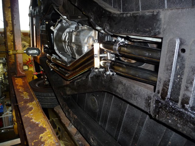

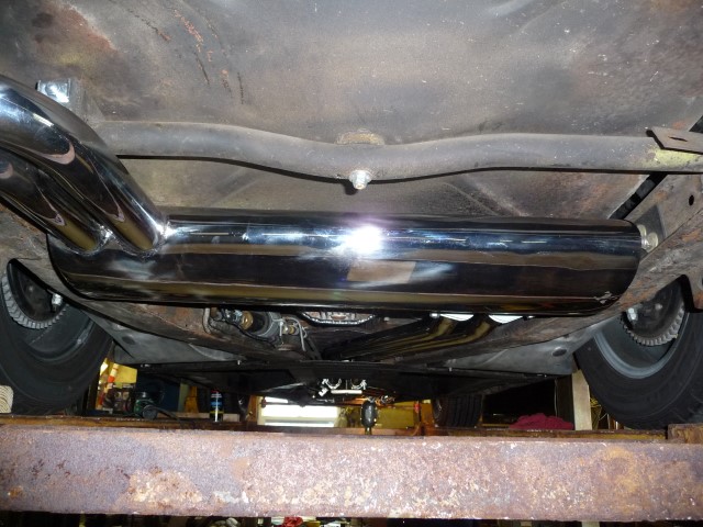

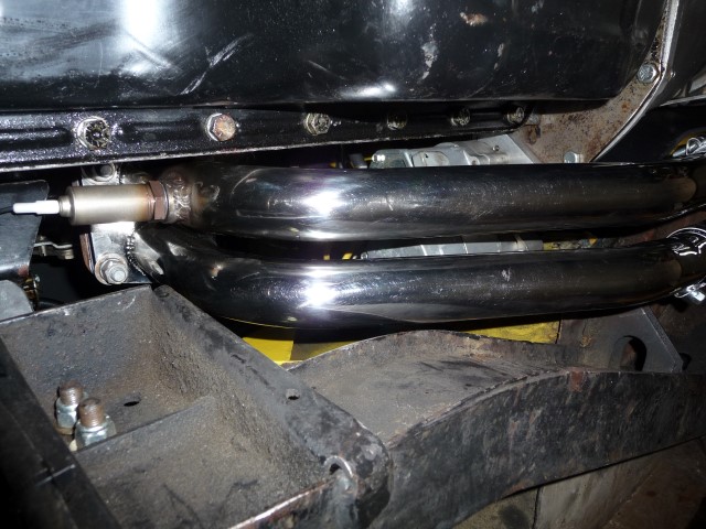

to me.... exhaust sound is personal.... when I got my car 17 years ago it had a Monza exhaust..... sounded great around town, setting off car alarms as I drove by but take it on the highway and it droned on and on and on.....15 minutes of highway driving drove me crazy so it went and stock steel exhaust replaced it. The stock system has a great throaty sound and highway cruising was a breeze. This year I decided my major project was the new Tourist Trophy SS system from Moss. Herman Van den Akker's car was the mule for development so I called Herman to see how he liked..... especially considering he is the King of long distance travel. Based on his recommendation I bought one and was blown away by the quality...... every piece of SS is polished to a mirror-like finish. It's a shame it's under the car! I love the sound around town and on the highway you barely know it's there.
