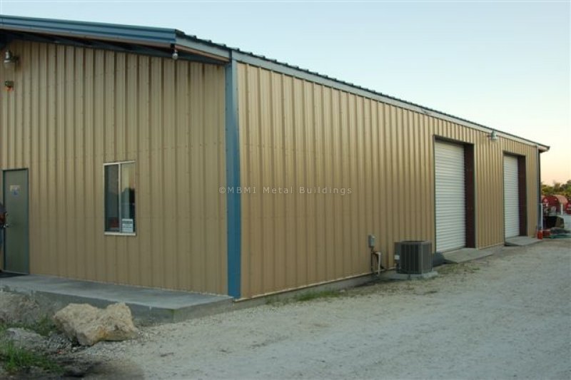

I'm investigating the affordability of a 3000 square foot storage annex at a local non-profit. One or one and a half storey, hvac, concrete floor, no basement, steel exterior, fully insulated, probably a slightly slanted roof. Will house several hundred shelf units and file cabinets, with minimal windows and no interior walls planned. Will be built onto the side of the existing two-storey steel building.
I'm just assuming "steel exterior" is cheaper than any other construction.
The annex would be similar to this, but without the tall doors:
We don't have funds for the building yet, so I'm looking for a ballpark figure as a basis for moving forward with the idea.
