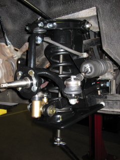

Done. That was a lot easier, especially on the powder coating!! :yesnod:
Nice and shiny Jeremy!
Scott
I absolutely HATE how I managed to scrap up the powdercoating last time I did this (without much grace or skill obviously).
Looks very nice Jeremy.
