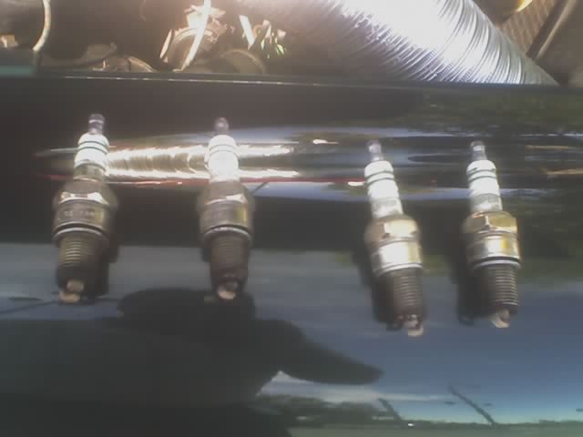

Well Trevor, Iwent out and took out the plugs, see attached picture. Right to left 1,2,3,4. All even light tan colour.
BUT, when taking them out I noticed that the number 1 wire was not "firm" on the top of the plug.
When reinstalling the plugs I made sure the wires all snapped onto the plugs.
Started and ran so much smoother on the way here, no backfire through the carb, no real bad burrble when letting of the gas in 4th or 3rd.
I believe that my 17 yr old must have hit the wire with the socket extension last week when he was rotating the dizzy and tightening loosening the nut, while I was under the car doing the timing.
SO, another problem turns out to be nothing but CO (current owner) learning. Ya know, this car makes me feel 18, and that I know nothing about cars. But it also makes me feel 18 when I DRIVE IT LIKE I STOLE IT, YEAH BABYYYYYY!!!!!!!

Ha, cheep fix. Bet it does not happen to you again.
Re: once more into the breach ...er carbs.. solved
Lets wait and see if the problem is totally gone. It sounds like there is more than one issue causing what you described.
It happened to me just after I messed with the carbs and turned out to be the connector inside the wire wasn't gripping the plug snuggly, was running like a dog.
New wires = run like a tiger.
Glad it's sorted but as Trevor said, keep your ear on it just in case something more sinister and less obvious is lurking beneath.
