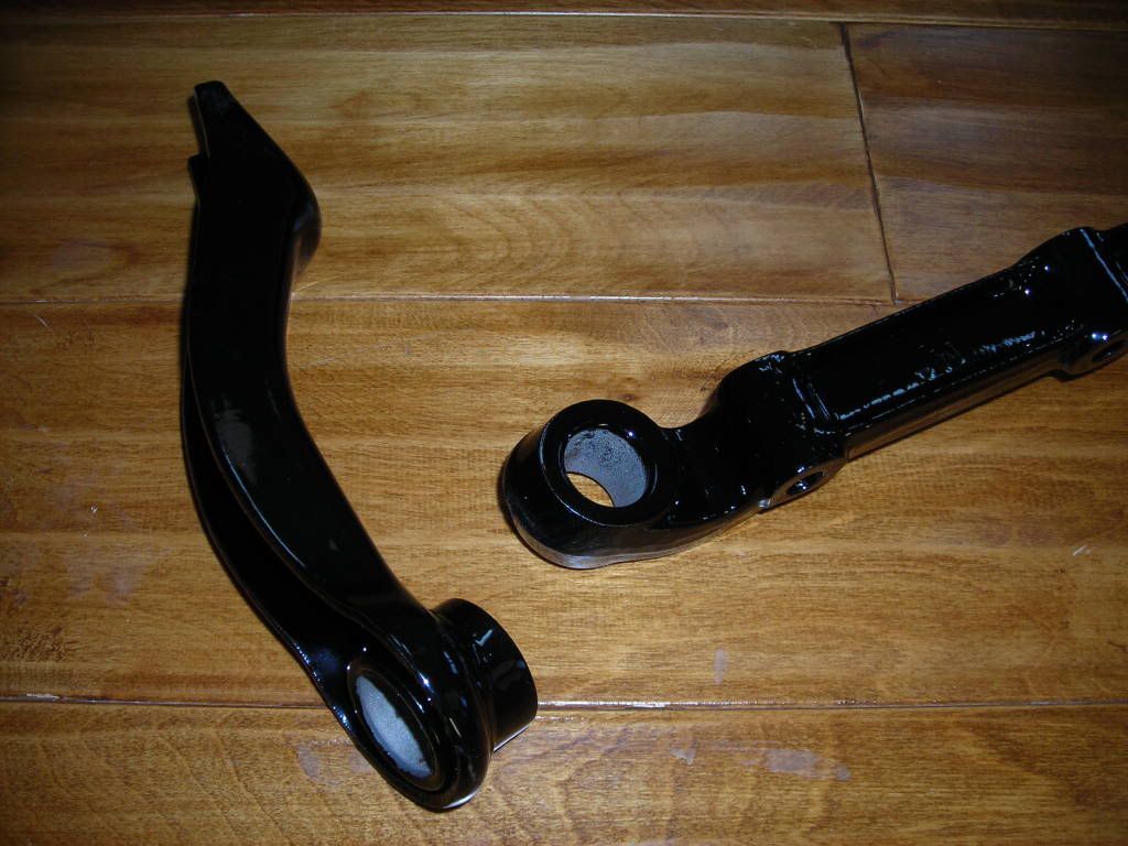

tdskip said:
Got most of the parts back from being powder coated yesterday, and the guys taped off the inside of the wishbone arms where the bushing goes.
I was planning on just painting the inside with POR15 before reassembling (and obviously letting it dry before assembling) Yes/no?
My vote is NO POR15 paint. But remember, Dale knows just about zilch of auto mechanics
and can barely change a tire. Anything I post is subject to rebuke by the BCF Experts.
One night I stayed at a Holliday Inn and the next morning I replaced the front suspension of
my 1969ish TR6. I cleaned and powder coated all parts myself and masked off the bushing openings
just like your contractor did to yours.
Not that I would know for proof positive, but I cleaned and polished smooth the A-Arm
bushing openings until they gleamed.
Now, I'll prove how non-mechanical I am. I installed red wheel bearing grease because
of the rotation movent of the bushing against the steel walls. I use red wheel bearing
grease on anything that spins or rotates.
I use Moly-B-Denum grease on anything that slides back and forth but does not spin.
Here's a quickie "how to" for the A-Arms install. Remember, I might be wrong!!
