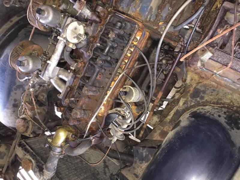

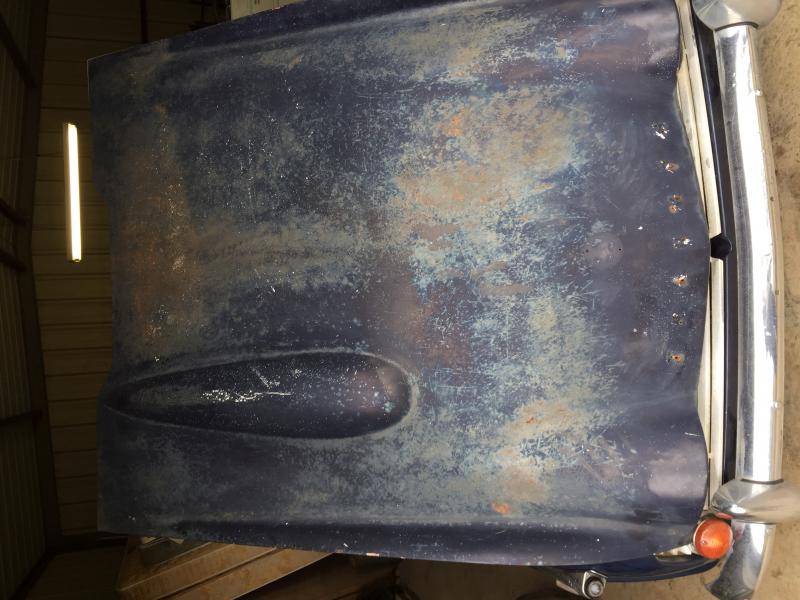

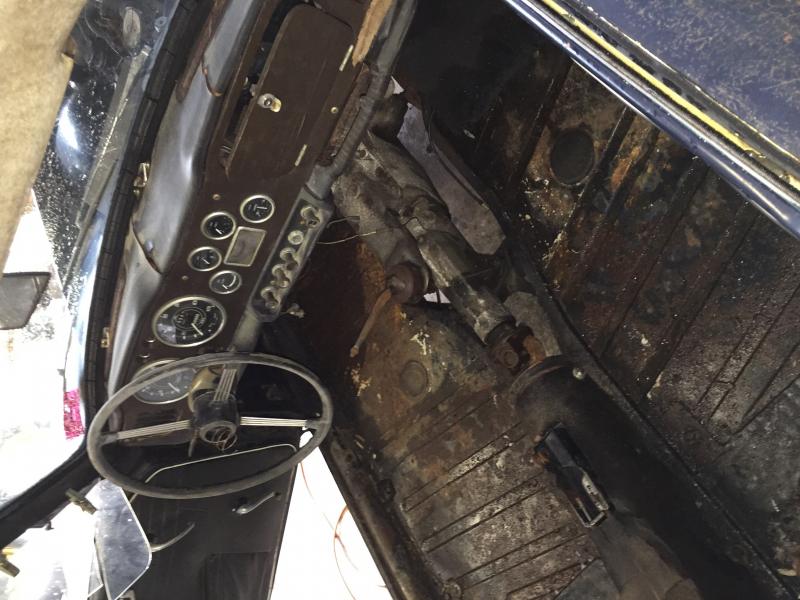

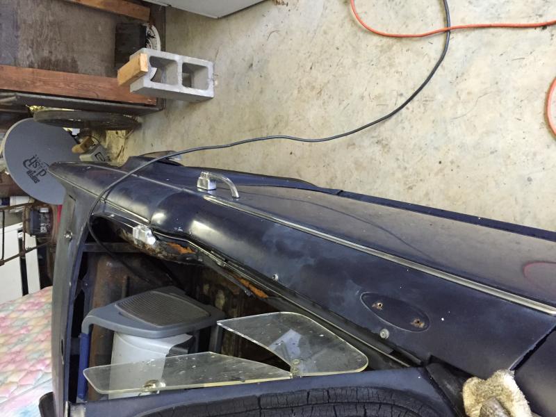

Just started poking around on my 4 and I have some body welding to do...is it best to weld in new sheet metal while the body is on of off the frame? Looking at boot floor, partial driver side floor, partial outer sill, etc. My Bugeye is a unit body and it's fairly straight forward with the bracing and welding, but this is my first 'frame' car. Sources for sheet metal would be nice to know as well.

I would think it's to your benefit to leave the body in place; that way, the chassis serves as somewhat of a jig to help keep things aligned. I've heard enough stories of sheet metal replacement of a body while off the chassis...followed by lots of screaming, anger and work to be redone when it was discovered that the door opening was now 1" too short, etc., etc., etc. :(

I agree with welding the panels on while on the frame. Just watch out for the frame getting in the way while cutting and welding. You do also have fuel and brake lines running under those panels if you are removing partial panels.

Couple things to note, before starting to cut and weld inspect the frame. If you find any kinks or dips or it otherwise doesn't match specs, fix those first so the underpinnings are straight. Otherwise you could find that fixing those issues later could mean redoing bodywork because it no longer completely lines up. And depending on how much you need to cut you may want to have some braces in place to ensure parts of the tub don't sag a bit and cause fit problem down the road.
