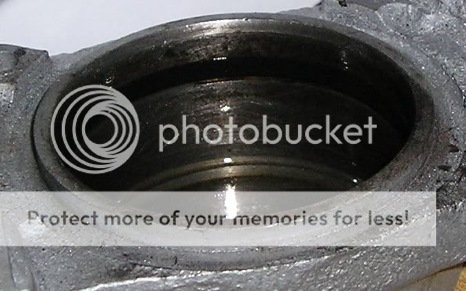

I just removed the old pistons from my calipers (16P) and am installing the new pistons I ordered from BPNorthwest. My new pistons are the "old" style and my old pistons were the "new" style. The rubber sleeves had clips on them before, but am I to understand that the sleeves for the old style do NOT require clips and instead just rest on the piston themselves (vs. clipping on to the rim of the caliper)? Here's a pic. I found on Buckeye Triumphs page:
Also, to install the pads, I've had to push the piston essentially all the way into the caliper and it appears that it will probably need to remain like that while I fit the caliper back over the rotor. How can I keep those sleeves on through that process?

My calipers are the 16P style (early) but the pistons I removed are the later style. I think my commission # would indicate that originally my car was equipped with the 16PB calipers. So maybe there was a switch of the calipers but a PO installed new pistons based on the model year? The article on Buckeye Triumphs website states that the two pistons are the same as far as diameter and width, so I'm guessing the main difference is the type of boot to use? My caliper has a raised lip but no groove for the clip to fit in. When I removed the old pistons, two of the clips were already loose. Soooooooo, in summary, as near as I can tell, my brakes should have been fitted with the early pistons but someone switched.

The earlier style casting will have a thin groove machined in the bore to take the outer lip of the dust boot.It is toward the top of the bore. (Of course there is another groove lower into the bore for the piston seal.)
The later casting has only the piston seal groove in the bore. There is a raised lip for the inside of the boot to sit on, and be clipped.
The picture in your original post is of an early style boot. The bit of the boot lip under the grimey thumb is what would go into the upper/outer groove in the 2 groove bore of the early casting. The earlypsiton has a very narrow groove as per that picture.
Hope this helps. Peter

I'm not seeing a slot inside the bore for the lower lip of the rubber boot. Am I missing something?
Nelson Reidel indicates in his article that the lower lip of the boot just rides on the cylinder. Looking at the diagram in the Moss catalogue, it shows the lip in a groove inside the cylinder as others have mentioned above. I'm not sure what's going on with my cylinder, but I don't see how I can fit that lip inside without that groove.
I'm baffled /bcforum/images/%%GRAEMLIN_URL%%/crazyeyes.gif
<div class="ubbcode-block"><div class="ubbcode-header">Quote:]That's a later caliper.[/QUOTE]
Hence my confusion. The calipers are clearly stamped "16P" and not "16PB".
