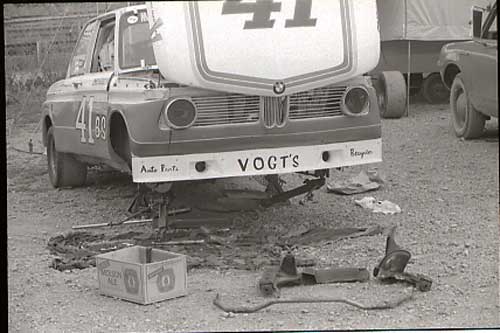

Well, it took some looking, but my brother found this old photo of the BMW 2002 that we crewed on in the late '70s - early '80s. My brother has been a professional photographer sinc the '60s, so that means <span style="font-style: italic">lots</span> of boxes to look through. This was the only photo of that BMW that he found.
This is in the paddock at Summit Point in about '81. It's still in B Sedan, not GT2, so that should help date the photo.
That Saturday morning Fred, the driver, came in from practice and yelled, "It's handling funny! Something's wrong!" The front wheels had <span style="font-style: italic">way</span> too much negative camber. My brother opened the hood and the engine was sitting too low.
The subframe had broken in two!
A 2002 is monocoque construction, but a subframe holds the front suspension, engine, and the whole front of the car together. You could see where a PO had cut part of the subframe away to provide clearance for an oversize oil pan, weakening it. The broken subframe can be seen in the photo.
Fred's shop, Mt. Airy Motors, just happened to have a new subframe in stock. A crew member was dispatched to get the subframe whilst the rest of us removed the broken one. We got everything back together but missed qualifying and Fred had to start at the back of the grid in the Regional on Sunday.
Fred passed about half the pack by turn 1 and finished at or near the front, I forget exactly where.
It's amazing the work that is done in the paddock, lying in gravel, under the worst of conditions. Fred said that, had a customer come into the shop for a new subframe, it would have taken a week to replace it, with the car on a lift, under the best of conditions.
Maybe Don was there that weekend. Those were the days, weren't they?
