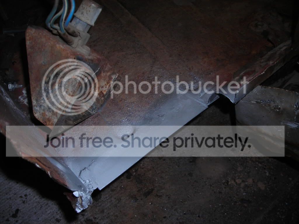

OK, OK. So the passenger side repair left a lot to be desired. I'm going to have to go in and butt weld the floor patch in. In my defense, I didn't need to remove as much metal on that side and wanted to keep the reference points, but still, that side leaves a lot of room for improvement. I'm not quite done cleaning up the front/back points but the middle long weld came out pretty well I think.
If I can do this, so can you guys!
Now on to the driver side, and with more room to work and thicker floor metal this came out much better. The floor looks worse than it actually is, it cleans up nicely with aggressive wire brushing and took the welds just fine.
I still need to trim the outside edge back some, but better to trim than have to try and add metal on an edge, right?
Dang, that looks pretty good. Little trimming and grinding needed but otherwise looks spot on.
Looks good. I will bring over some of my projects.

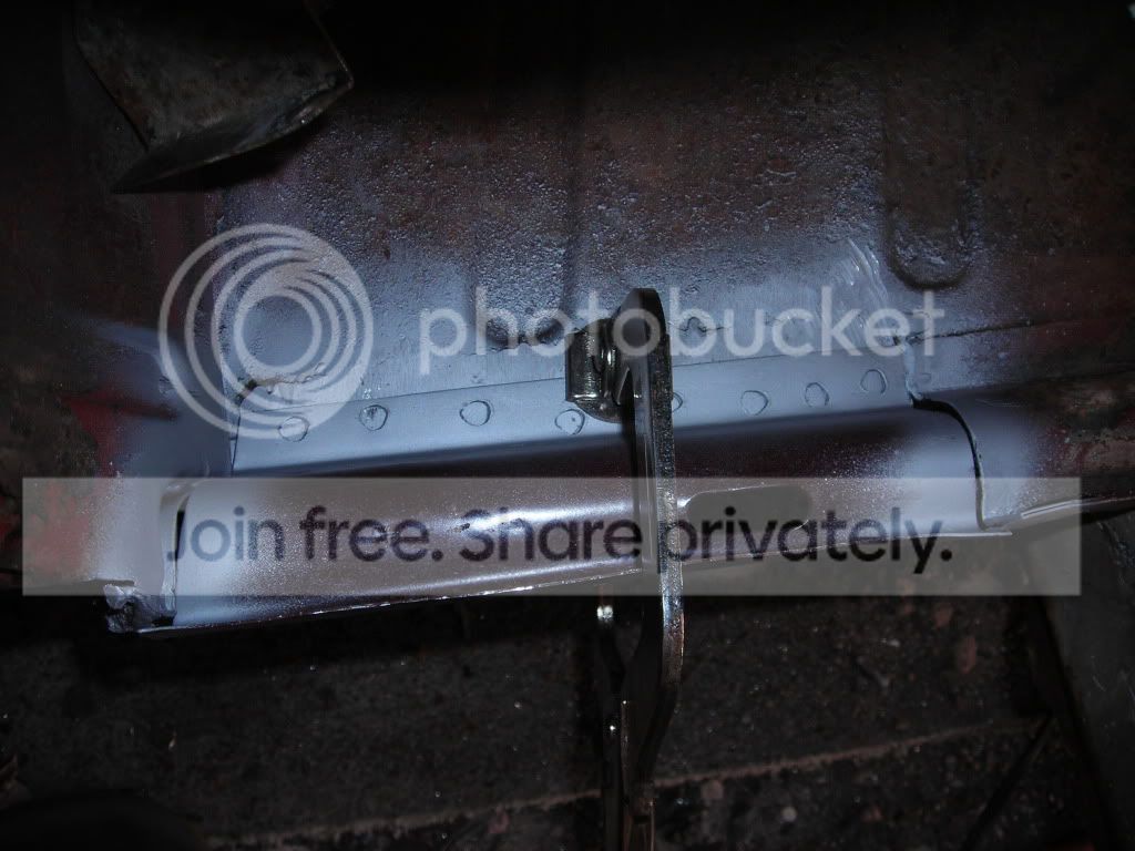

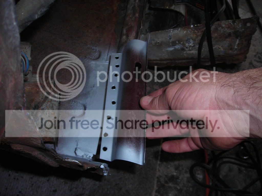

Some more progress;

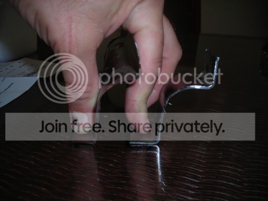

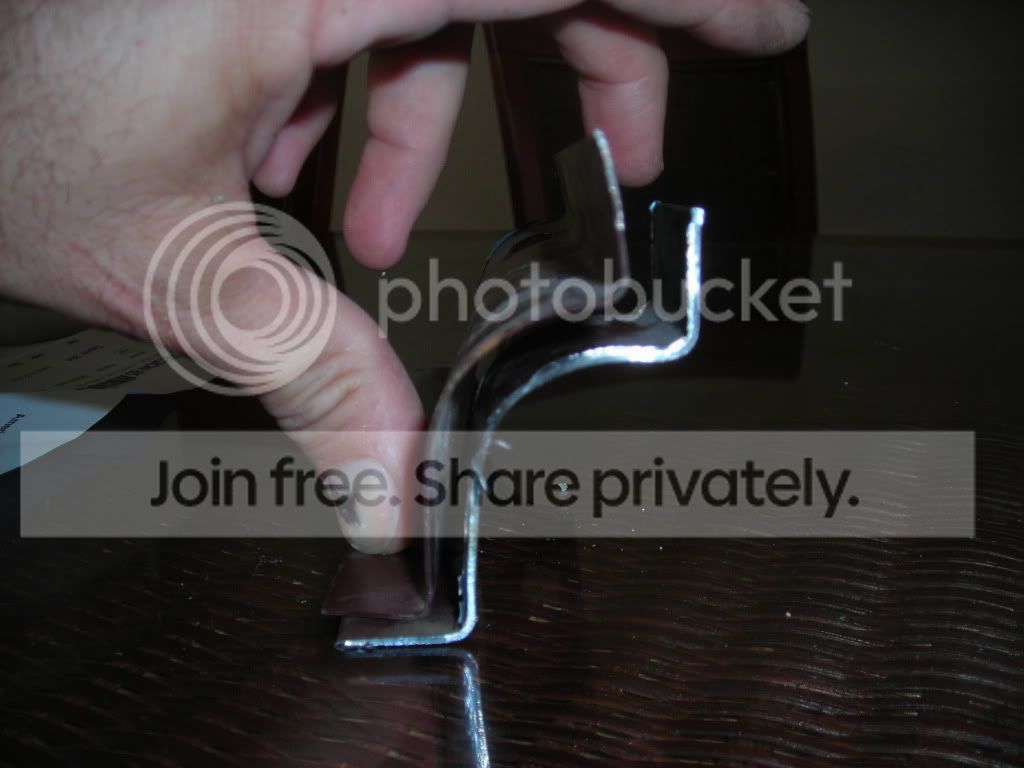

As you can see, these sills aren't quite the right shape. It took about an hour of re-working them to have the same contour of the existing sills. I don't think I noticed this yesterday since I lap welded the passenger side in.

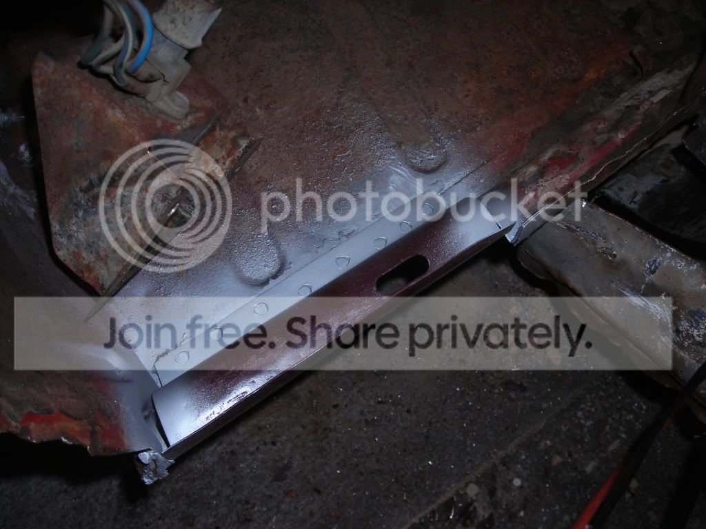

Not the best job of aligning the holes. I started off thinking I would stagger them, but.....

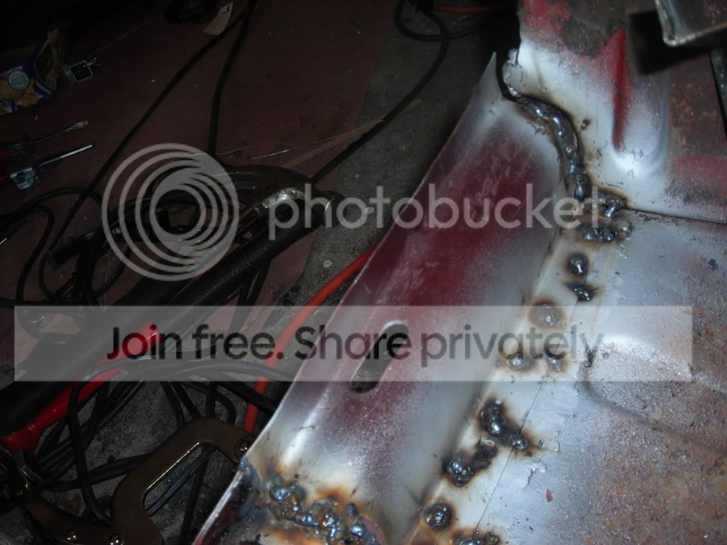

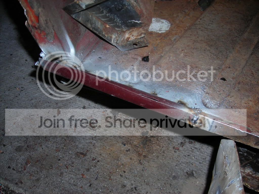

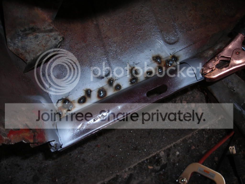

Test fitting and clamping
Initial welds
It took a lot of hammering once the bottom and lap welds on the rear most side where in place to get everything to line up.
Certainly not perfect, but I don't think you'll be able to easily notice the repair once ground down and the seam filler has been installed.
I did some more shaping and the gap you can see on the front is closed up now.
