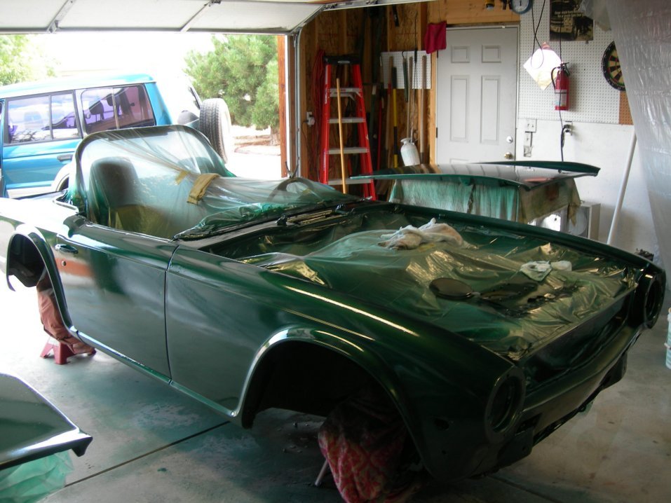

Sound advice. I just finished painting my TR6 2 weeks ago. I used the 2 stage process - color and clear. I had experimented using the single stage under the hood to find the correct color of dark metallic green. That said.... I used the Nason brand of primer sealer (1 qt), color (3qt) and clear (1 gallon). Add to those the proper amount of reducer and cataylst. The budget was less than $400 total.
Clear is tough to get right. Yeah, the organge peel spirit was hanging out. The HVLP gun was a nice unit and able to remedy the problem. I had to re-spray my doors because of runs....ugh. ONLY thing I found out was (as stated above) put on the first couple of coats VERY VERY lightly.
All in all I'd do it again.

Looks very nice. It also confirms the suspected quantities. A few questions for you. What brand/model of gun did you use? What size compressor did you use? Lastly, since it looks like you did it in your garage, how did you ventilate it?

The gun was a generic gravity feed HVLP from NAPA ($120). The nozzle was a 1.3. Personally, the DuPont supplier(NASON) had a better selection - around $110-150. I should have bought the gun there.
I have a 20 gallon 2-stage cast iron compressor. At gun pressure was 18 psi. It ran for almost the entire time. I was told to start with the primer, let it flash and then keep going - bearing in mind the flash times for each component. The key was with the hood and trunk removed (and treating them like separate items)it was able to keep up with the air volume. I lined the garage ceiling and sides with 1 mil plastic sheeting and watered the floor to keep dust down. Only issue was the few bugs that came in. They tended to stay away from the fumes.
I had the entire door open to let it vent out. The mask I had was recommended by the paint shop and I was not able to smell much of the odor. I had my wife helping mix up the paint, clear and such... outside away from the spraying.
I put on 5 coats color and 3 coats clear - about 3 hours.
Whew.......

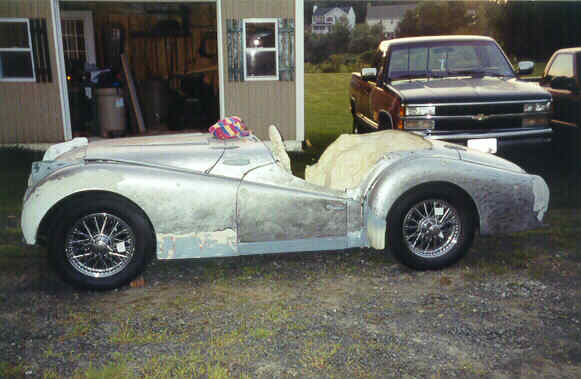

No black art to stripping it down to bare metal. It's alot of work and you just may not like what you find. In my case I found bondo in all the anticipated areas. Also do not keep it to bare metal to long because the rust devil starts to take over even on the least humid of days. Take your time, read as much as you can, and by the time your done you will have mastered another skill.
