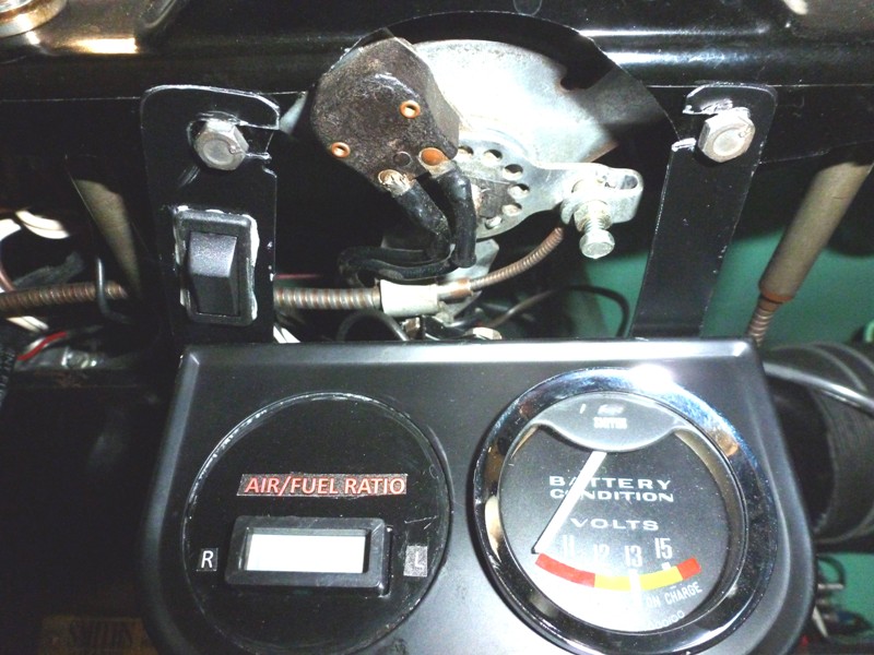

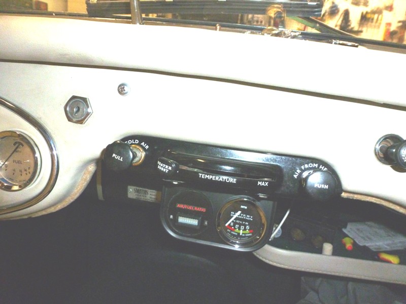

Peter Roses mounted these gauges between the heater control and the top of the heater box:
Steve, where did he place the sensor?
I was showing those because there was also a question about gauge placement. One is a volt meter; the other is a K&N Air/fuel meter using an O2 sensor in each exhaust downpipe. There's a rocker switch on the left-hand mount to switch the gauge between sensors.
Hopefully that answers the question. :smile:

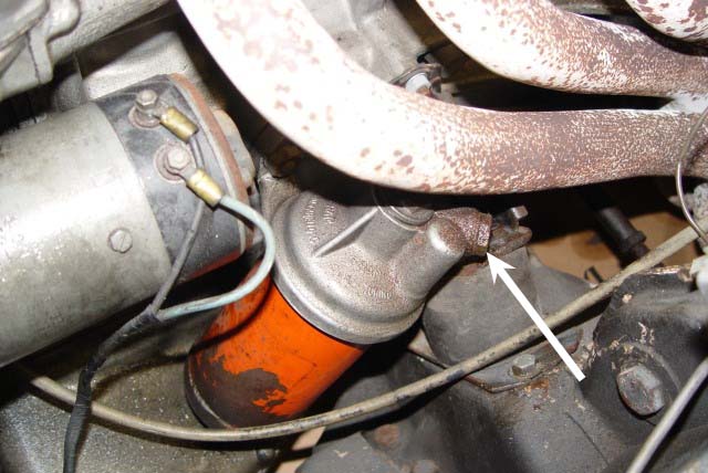

PS - here's a stock Alfa 4cyl sender on the oil filter mount:
OilTempSenderAlfaStock.jpg Seems like it would be easy to install one onto a spin-on filter adapter.
