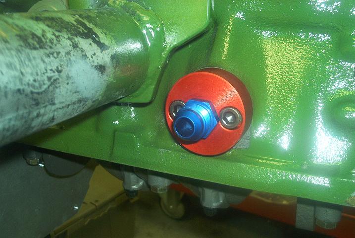

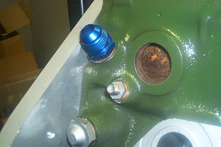

Hap, to answer your response, I had already switched the outlets on the new block to -AN not knowing (or rather not remembering ) that the fittings on the oil cooler and old engine coming out of the car were not the -AN but rather the BSP. So now I have a block going into the car with a -AN adapter on the outlet and a -AN adapter in place of the stock filter assembly at the return point to the block. I have a remote filter assembly with two -AN fittings. All my hose connections are female BSP.
So, leaving block -10AN to filter housing -10AN: No problem, have it.
Leaving filter I will need a 1/2" NPT male to 1/2" BSP Male adapter
From oil cooler into block I will need a 1/2" female BSP to -10AN female adapter.
I hope I can find all of those.
If not, what if I put the original oil filter assembly back and had the oil cooler go back into that? i.e. block->filter->cooler->filter->block That is the connection point that exists now. Would it be bad to have two filters in the system? Would it be too restrictive? Just thinking out loud.

Jack, you can get both of those adapter fittings at Pegasus Racing, www.pegasusautoracing.com
JACK
Here's the end results after a few quick adapters for the adapters! :laugh:
Some day I will ebay these british parts and swap it all for the more readily available -AN stuff. This'll do fer now. :wink:
JACK
