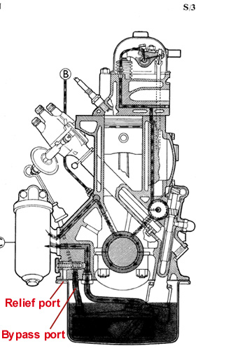

As you know, there is a serious problem.
Some possibilities are:
1- The pressure relief valve is not seating due to a deformed seat or plunger, or contamination on the seat. Excessive friction in the plunger/spring could cause the relief valve to stick in the open position.
2- The oil pump internal clearances are excessive. The pump gear to gear, gear to housing, & gear to end plate clearances should be no more than about .002".
3- The high pressure copper pipe connection from pump to block could be fractured or it's connections leaking. I highly recommend a high pressure flexible braided replacement pipe here. There have been several accounts of this pipe fracturing & losing oil pressure. Denis Welch & maybe others have a replacement pipe.
4- The pump intake pipe may be loose or damaged.
5- One or more crankshaft or cam bearings may have excessive clearance.
6- One of the internal oil way plugs in the block or head may be leaking or missing.
From personal experience, a Hundred Four should have around 40 psi pressure at hot idle & rise quickly to around 60 psi at anything above 2,000 rpm even when very hot. Assuming that you are using a SAE 20W-50 rated oil.
I have attached a drawing of the oil system routing & connections.
D

Re: Oil pressure on the 4 cylinder cars? [1st post
Dave,
thanks for the reply, useful info, I hope when I get in there I'll find something that is obviously the cause.
You say clearances in the oil pump should be .002" max, how bad is bad? if its .004 is that likely to be the cause?
This engine had a crank grind and all new rocker gear 900 miles ago so there must have been somethign very wrong in there...
Hi Ben,
I can't really say that .004" clearance is bad enough to cause a serious problem. It could cause lower pressure but I wouldn't expect it to be the main problem. Just carefully check ALL of the items I mentioned. Let us know how it goes.
D
