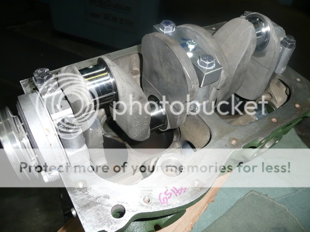

I was really hoping for a little higher oil psi at idle. I drove the machinist crazy with my crank and rod clearances of exactly 1.5 thou as Hap recommends. The good news it almost does not leak oil, seems to leave a drop on occasion, not sure from where.

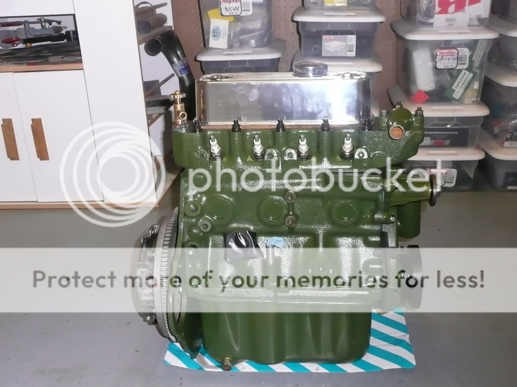

Would like to go for a real cruise but my wife and kids have to many other jobs for me. I will post any additional observations I find. At the moment I would say psi looks more stable, but need to drive more. Have a load of pics I need to share, just got to get to them

Yes it is beautiful, my wife tells me her horse is beautiful, she says I am sick

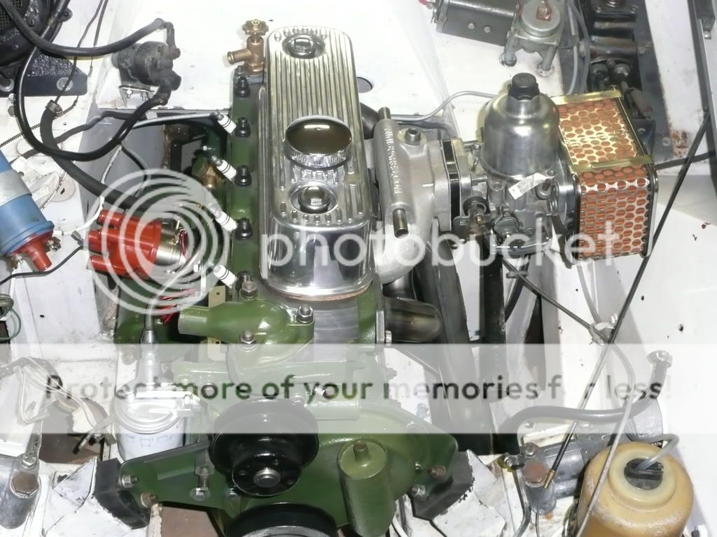

I have my idle at 900rpm, using the swiftune SW5 cam, oh it sounds so good. Must say the HIF44 carb is very easy to tune, miss the look of the twin Su's but there is a big performance improvement with my setup.
